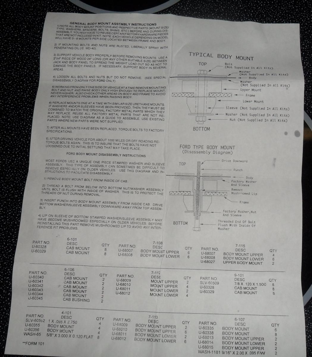

OK here is the instructions Attachment 19471 BTW top of bolt is 14 mm nut on bottom is 17mm.
