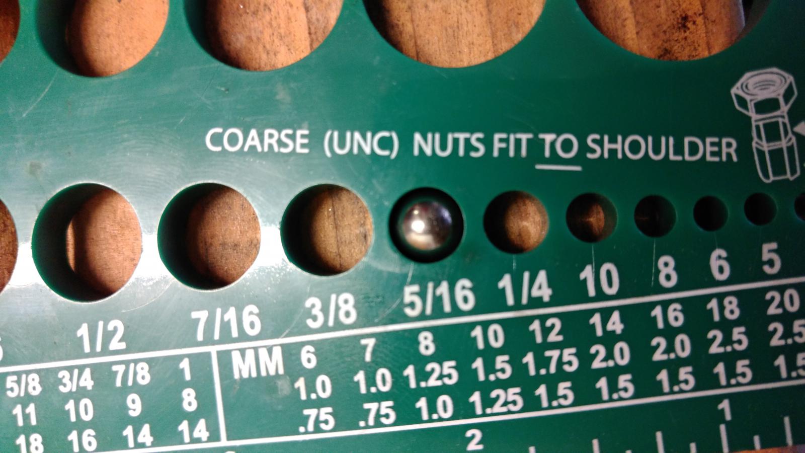

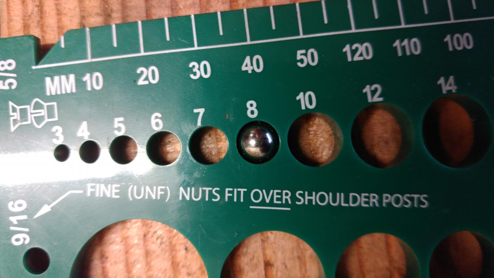

Reverse Switch Ball Specs
As requested by Geezer I did my best to get the specs for the little metal ball for the reverse switch. I don't have calipers but I tried to use my little multi measurement thing to give you guys a good idea. In the 5/16ths hole and 8mm the ball is just big enough that it slides in and out of the hole with no resistance.
Attachment 19427
Attachment 19428

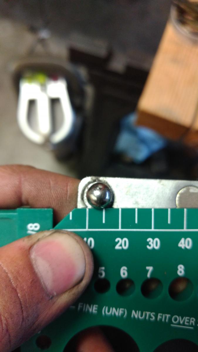

This measurement is in millimeters so as you can see its like right in the middle between 5 and 10mm
Attachment 19429

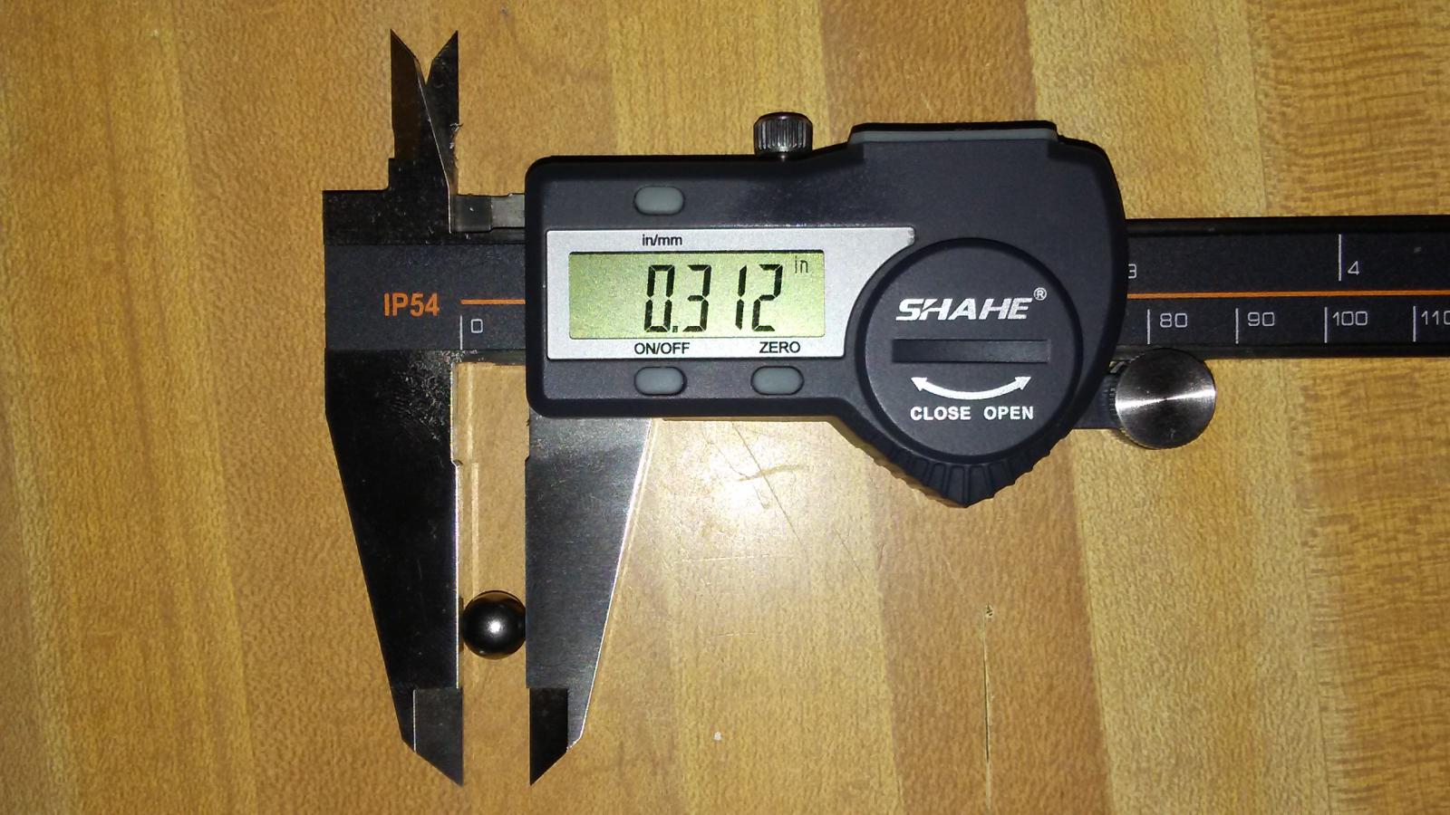

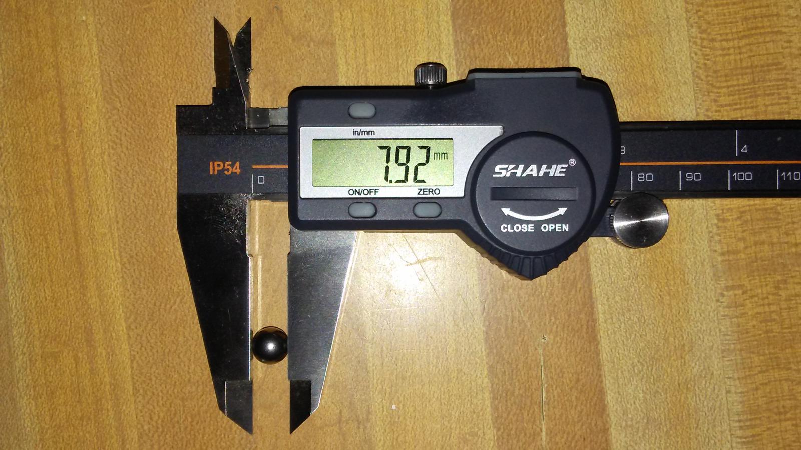

Digital Caliper Measurements for Reverse Backup Light Switch Steel Ball
Thanks Chyrio for taking the time to make this thread. You are awesome! Just to add to the thread, here is measurements taken with a digital caliper:
Millimeters:
Attachment 19430
Inches:
Attachment 19431
