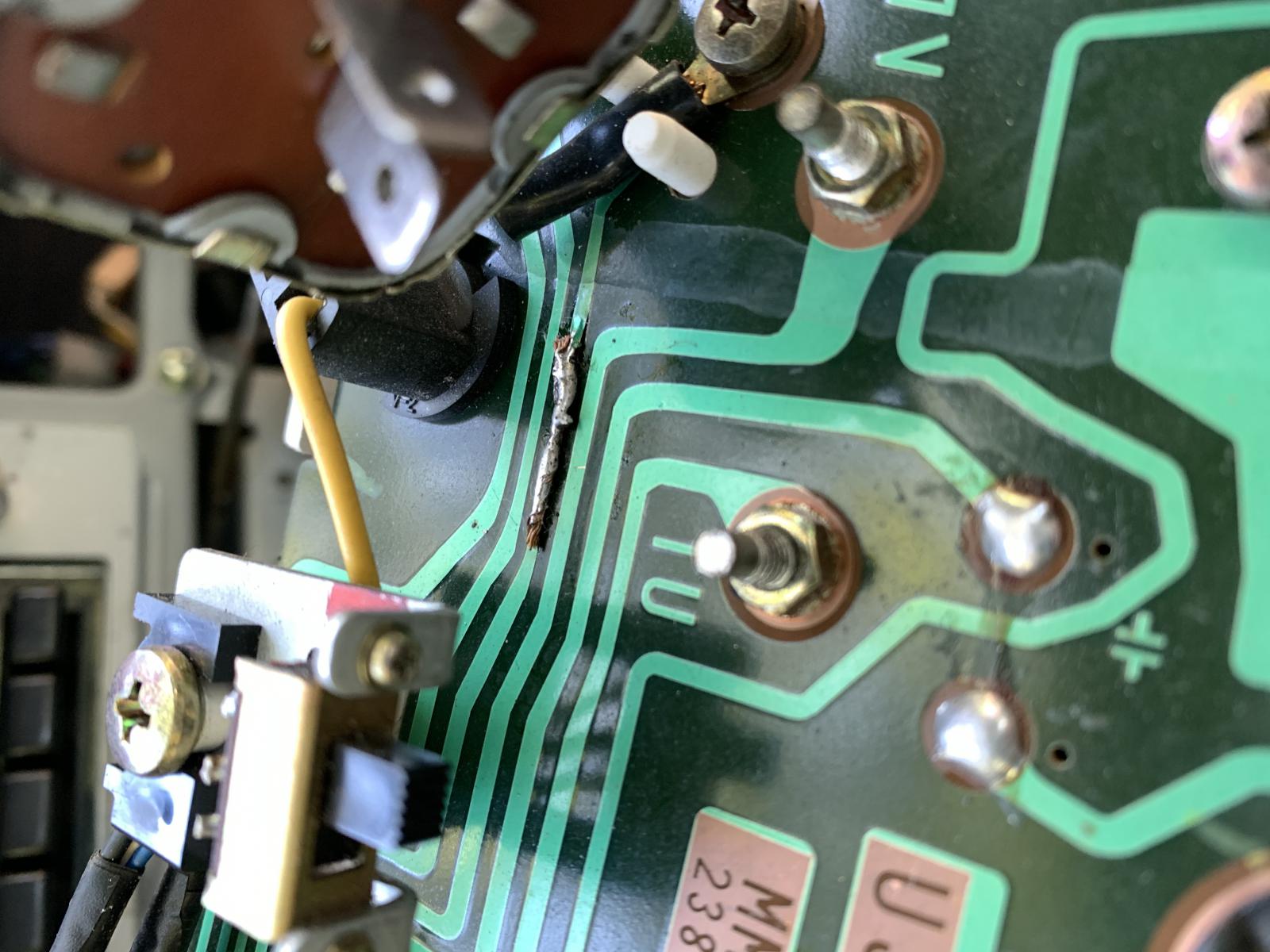

I got the gauges working by bridging the burn't section. Going to put a in-line fuse in. Don't know why it happen and it wasn't the 7volt section that still good.

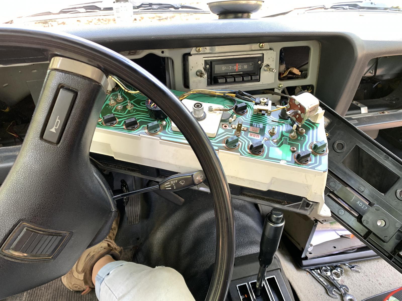

Anyone still following this thread? I'm having a similar issue with my lights and gauges. I bridged a section of my circuit board and cleaned corrosion but that didn't seem to be the issue for the gas gauge. the rest of my dash is working a lot better but still no gas. Think it could be the float? I feel like thats a whole other can of worms.
anyone had similar issues?

Disconnect the fuel float sender and use a pocket multi meter to test resistance across the connections. If you don't get a reading (open circuit) then the sender is toast. Try giving the terminal connections on the sender and the harness a clean - could be a bad connection (worth a try...) Anyone who passes this post - take note of image #2. That is the infamous service light reset switch ;)
*Oh - And nice solid state shifter handle :grin:

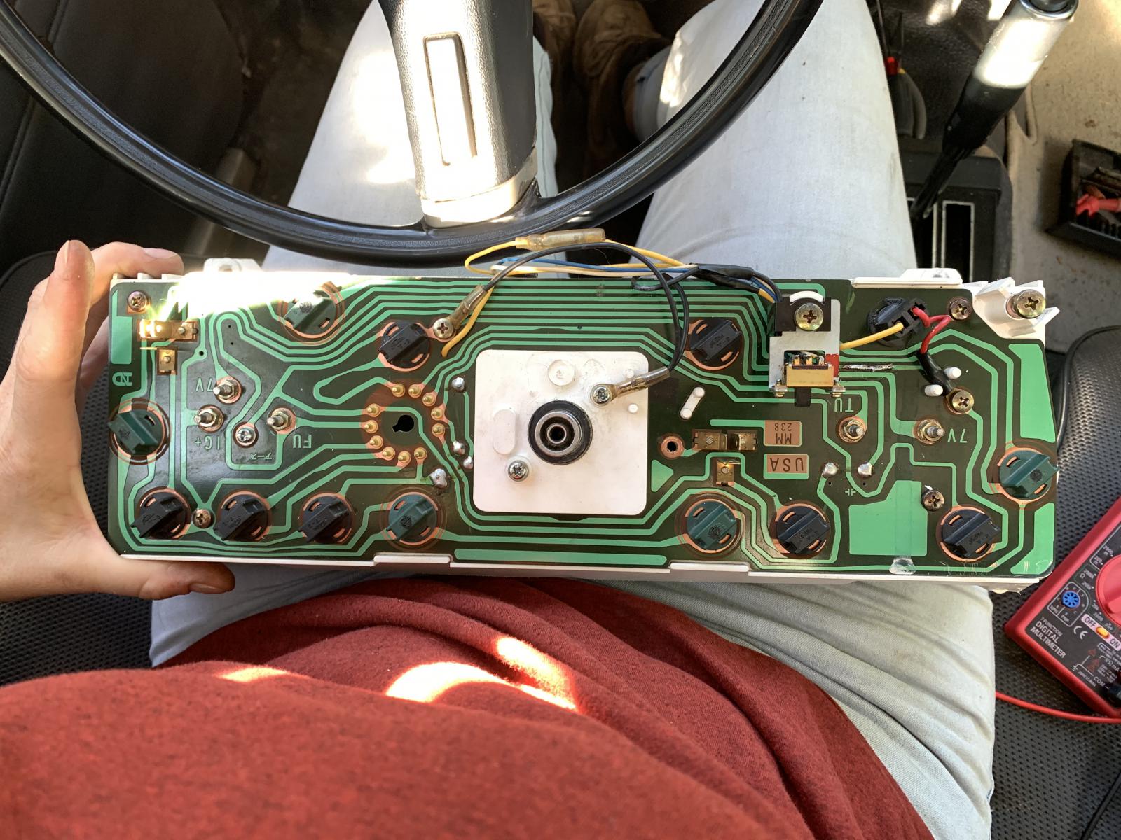

So this is my first venture using a multi meter (and honestly, car repair all together). I've got the manual, and am trying to look at electrical diagrams. Honestly, i'm very lost, and now i've bumped something related to my headlights, which have stoped working, so that should be fun finding that... i'm sure another post down the line.
question: Where might I find the terminal connection for the sender? by the tank? The Haynes manual i have, doesn't really say much about the fuel sensing unit.
on a more positive note, the temperature gauge is working very well now (it was only working intermittently before). I've read on here the fuel and temp gauge are linked on the circuit board. Does this maybe mean its not the board?
and, for the sake of more photos. here's the second time I took my dash cluster apart in hopes of finding a loose ground.
Attachment 24977
thanks for all the help!
The sender unit is actually in the fuel tank. It drops in from the top of the tank and is held down with 5 screws. If the tank hasn't been touched, this is gonna be messy (expect a lot of dirt and road debris up under there) I know you have no hope in hell of accessing it in a Gen 1 without dropping the tank so I would imagine it'll be the same story for a Gen 2. Your little pocket multi meter will become your best bud once you get to know how to use it. Good news - there are new sender units available for Mitsubishi trucks so if it is dead, you can get a brand new one without having to play roulette with a used one from the local JY (if you can even find one) I posted up a link for a member that I'd found on ebay a while back.
