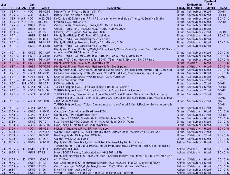

As geezer mentioned was correct, but you always want to be sure of the block size your working with or on at anytime a major overhaul is done. Nothing like performing a ton of work and finding out the block is an inch to big or too small. There is only 1 inch difference between the 2 block styles and I have seen mistakes that were costly.
Attachment 19076
block sizes and vehicles with our blocks
