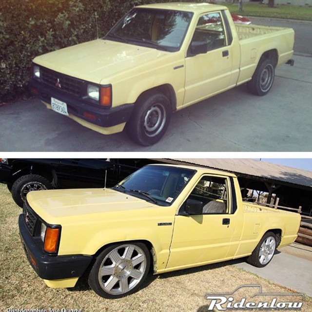

whats up everyone i'm a new member but not new to this and previous forums like this one. thought id post my truck and some of the problems that are driving me crazy.
i have a 1991 MM single cab, 2.4L 4g64 in y59 San Marino Yellow. here's some pics from over the years.
Attachment 19060Attachment 19061
last year my camshaft sheared in half between cylinder 2 and 3 driving home on the freeway. Since then ive installed a new camshaft but the truck continues to misfire and run shitty. good compression, spark, timing (checked a million times) but i did notice a wet exhaust valve on cylinder one when i removed the manifold and when i disconnect the fuel injector plug for cyl #1 i dont hear the engine get worse. replaced the injector but problem persists?!?!? id like to check ground pulse from ecu or maybe this is a common problem among 2g fuel injected trucks?
Attachment 19062thanks for the help and thanks for having me!
