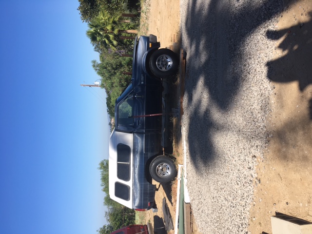

Hello everybody!!! I purchased an 84 Ram Royal 50 4x4 vin # jb7fk44e4fp501376.... i would really like to restore this vehicle as a daily driver. It's straight as an arrow, turns over but wont start....I'm a contractor by trade so I know how to get things done.... that being said my mechanical abilities aren't the best. I joined this forum in the hopes of gaining direction an technical info on how to get this beauty up to speed. I do live in California so I do have to contend with smog requirements... anyone interested in helping me get this show started??
welcome!.......show us some pics & i'm sure the comments will start flying....I'm under the impression you have completed the usual swop-out of cap, rotor, wires, plugs.
i haven't done a thing yet... i will post pics this week! (need help from wife) i take that back,,, i did pull the wheels off and will be taking them to the shop tomorrow for some new shoes, the wheels are polished stock aluminum mags off of a toyota4x4. the tires on it where dust and i need to get it to the shop for diagnosis on saturday
