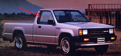

You know that plastic panel on the side of the cab behind the door? I think its a vent of some kind. How does that come off?
I would assume it just pops off but thought I better check before I break something.

Inside the cab? Down in the bottom corner where the seatbelt feeds out from? That just pops out. If it's something else you're talking about, a picture would help.
Sorry about that. This one.
Attachment 18818
The big black one that about 4 inches wide.
It just prys off its held on my the same type of clips as the a pillar. I used my harbor freight trim removal tool but it takes quite a bit to get it off
Any advice on where to pry?
I pryed on the back side closest to the rear window be careful though theres a little rubber gasket there as well

I must have pulled 8 of those things off and it was always the same. It just pops off but virtually all the clips break. I think I came back with 2 unbroken clips. There are 4 clips per side, 1 top center, then 1 a 1/4 of the way down and slightly towards the rear, one 3/4 of the way down and slightly towards the rear, and 1 bottom center. It was easiest to start at the bottom. I used a flat prybar, inserted it under the panel then worked it in until I found the clip. Then it was a simple pop. Repeat for the others.
