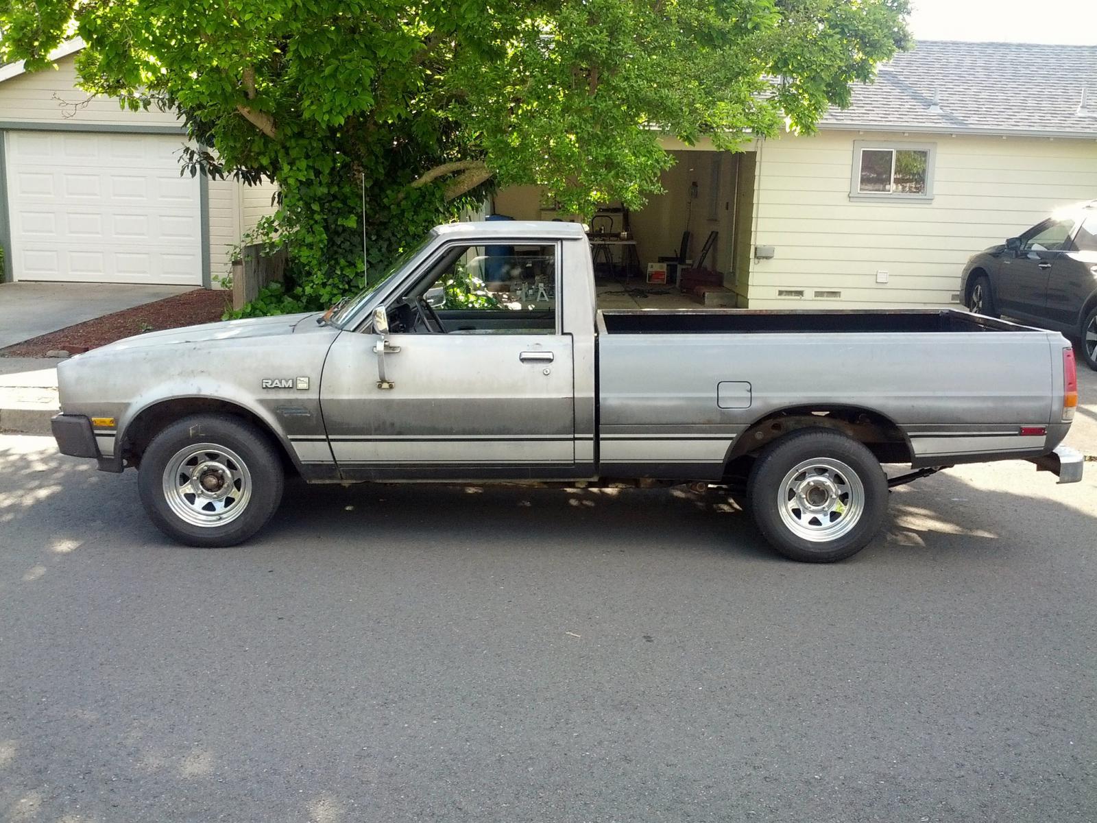

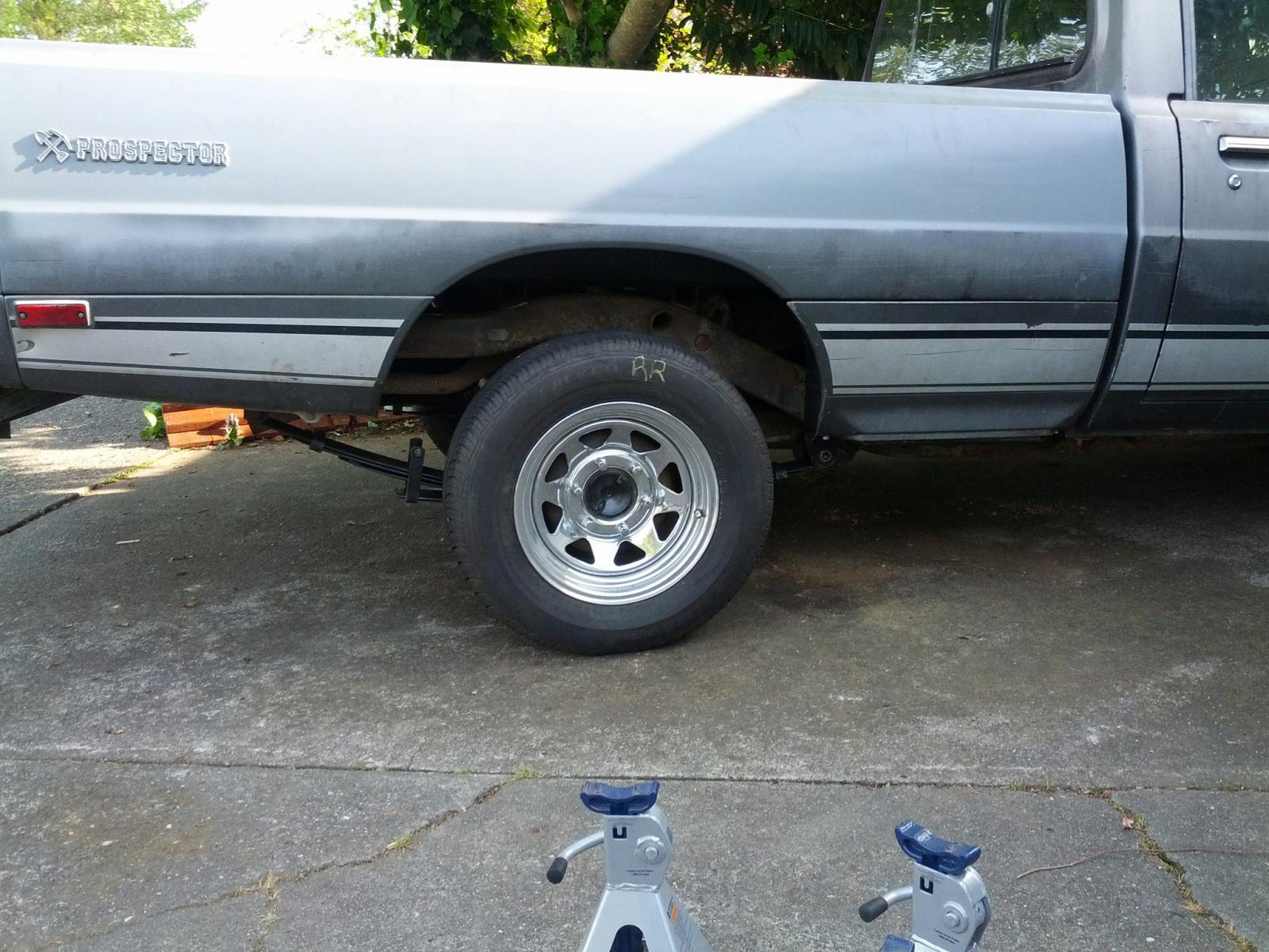

First, the finished product. Rear done:
Attachment 18737

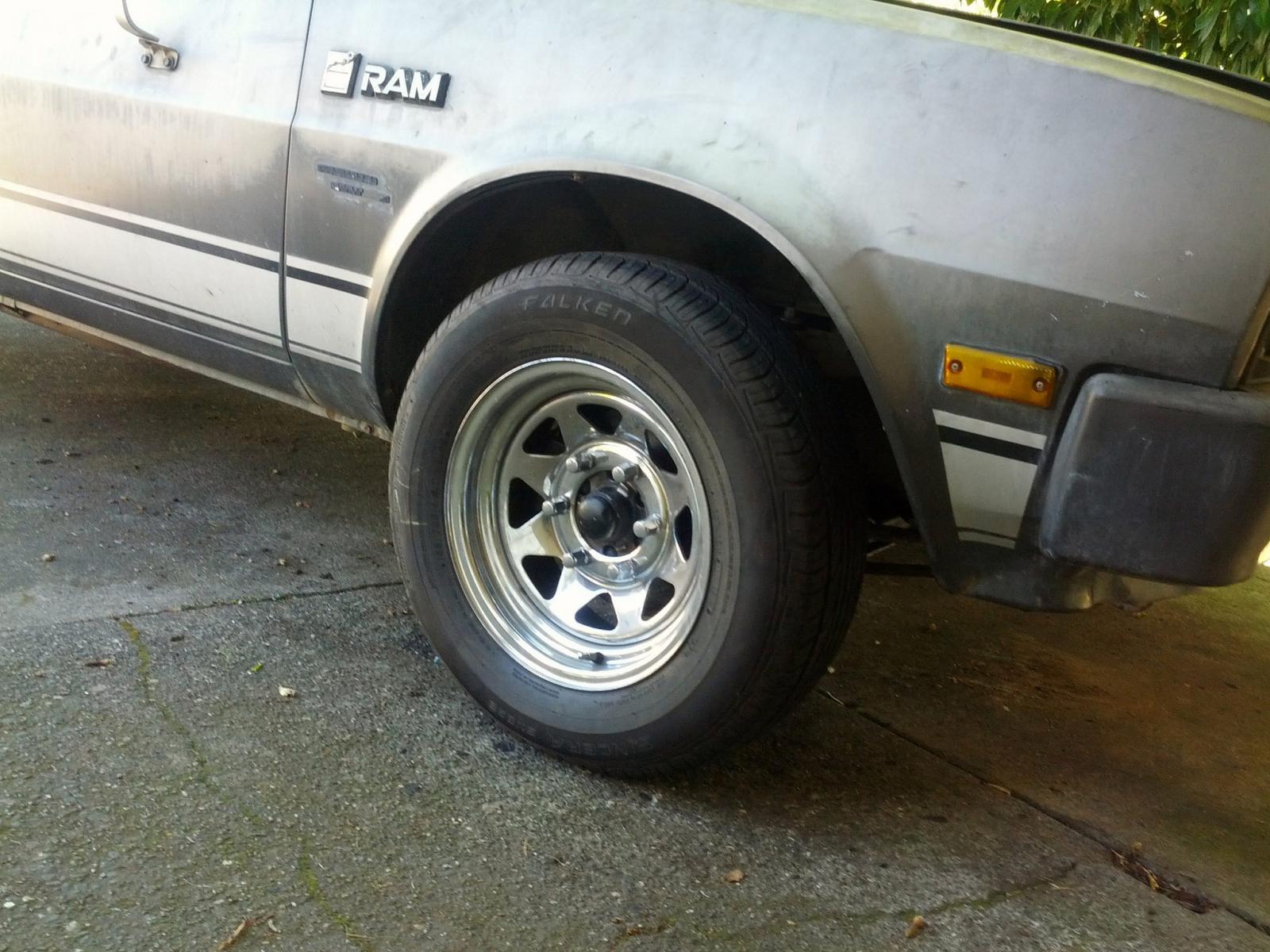

Front done:
Attachment 18738
And a nice profile look
Attachment 18739

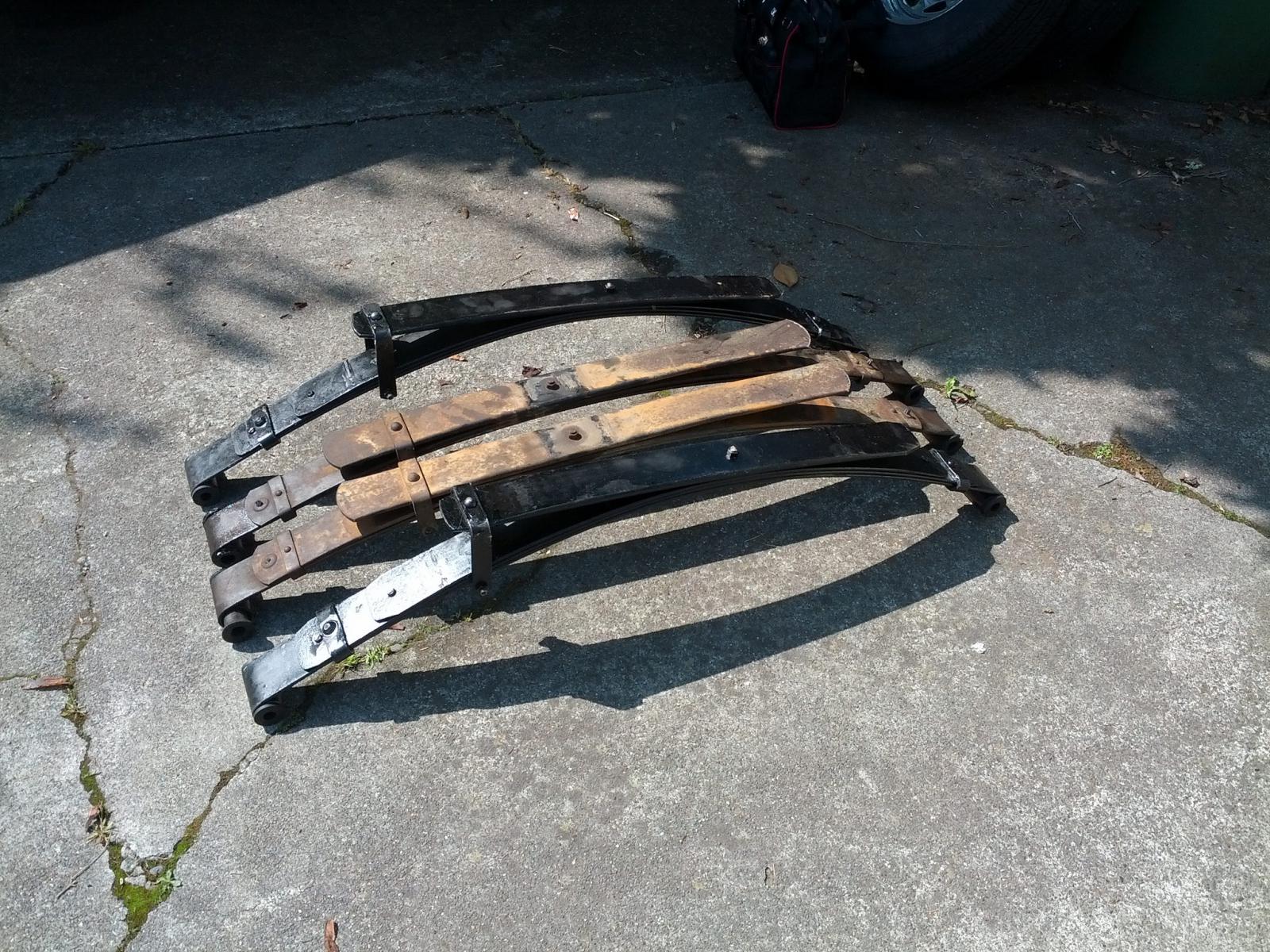

Attachment 18740
I cannot stress how garbage the old leafs and shocks were. The shocks I could push in with two fingers, the leafs I could put a hand-compress. Absolute. Garbage.
