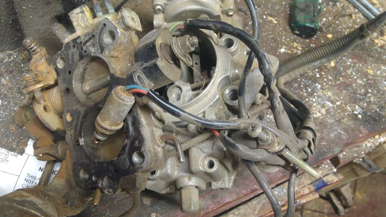

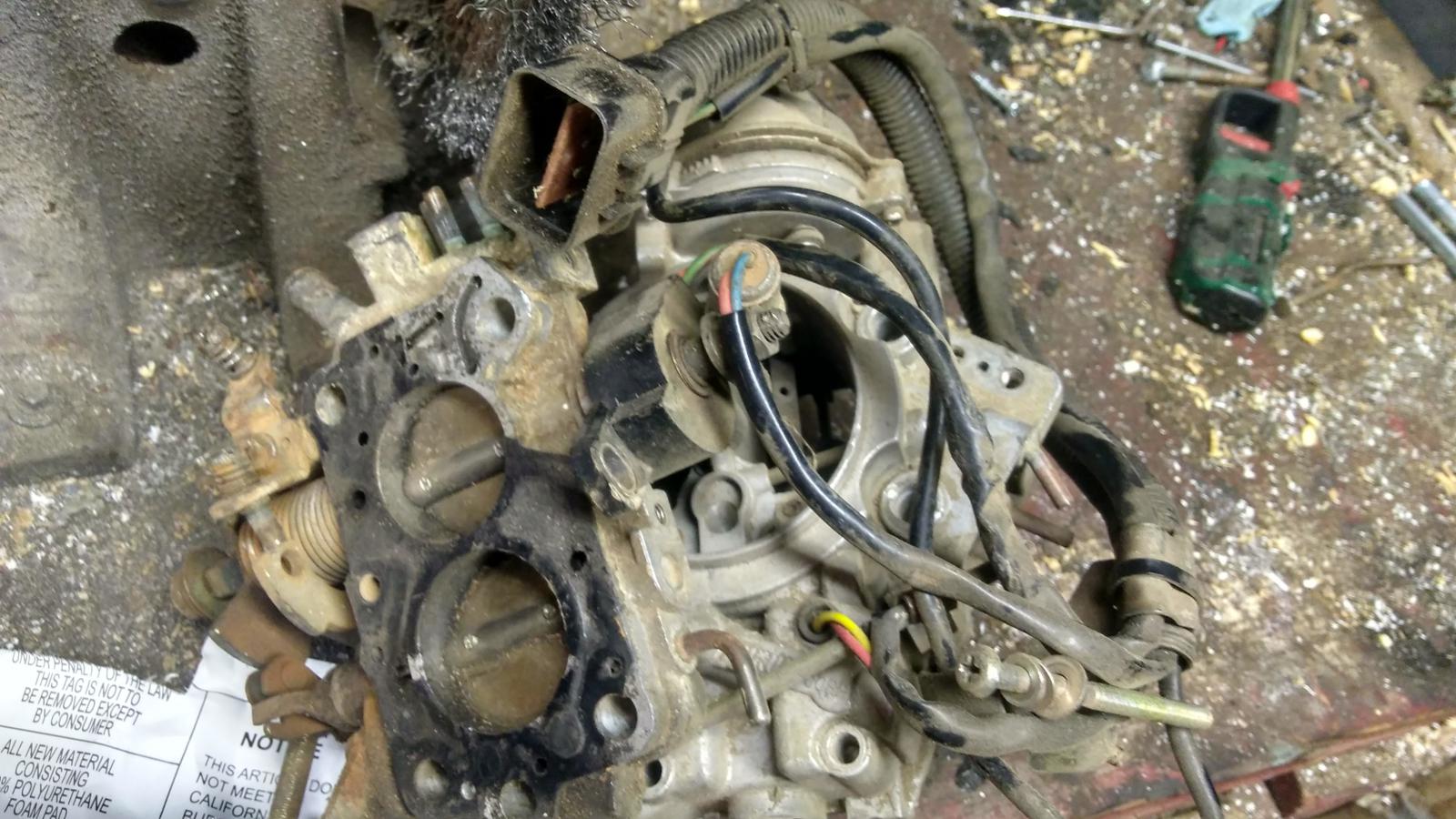

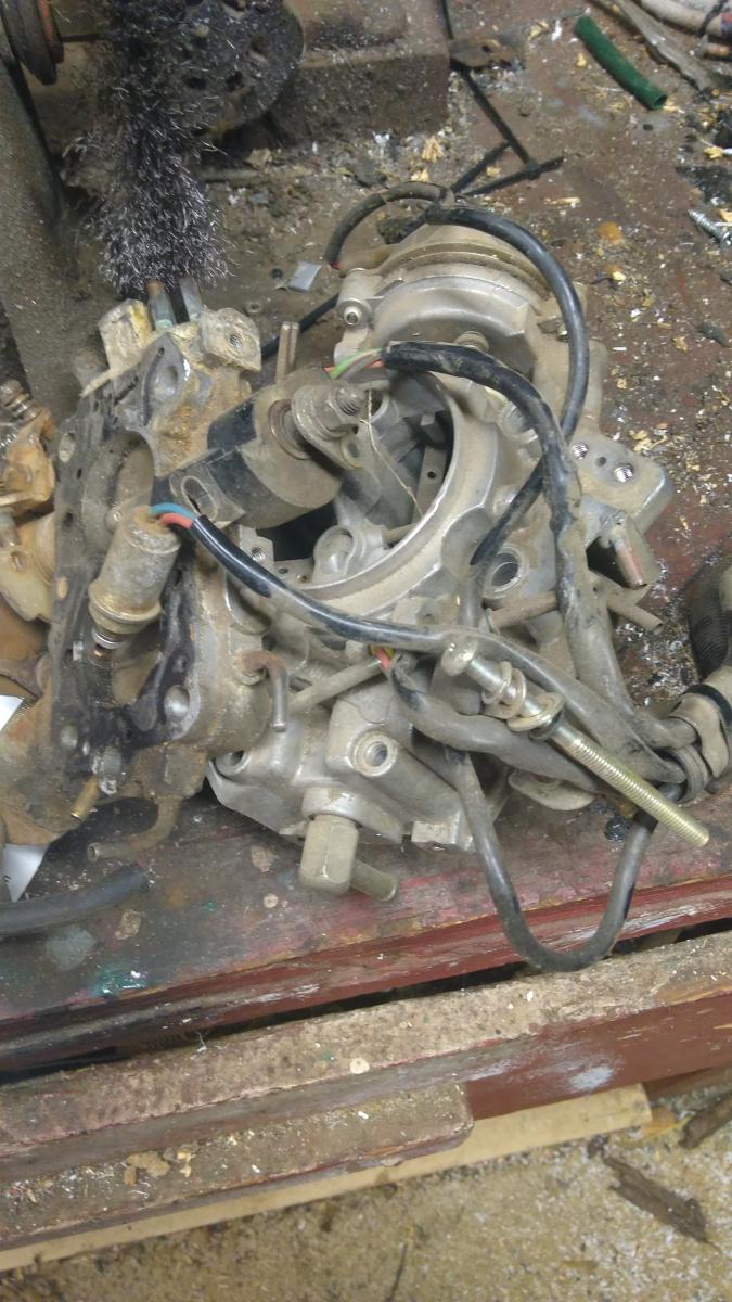

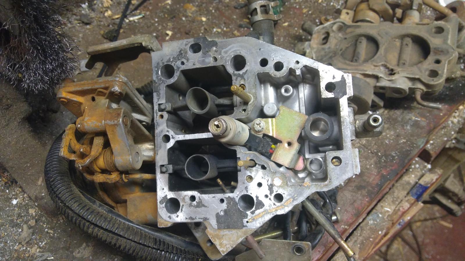

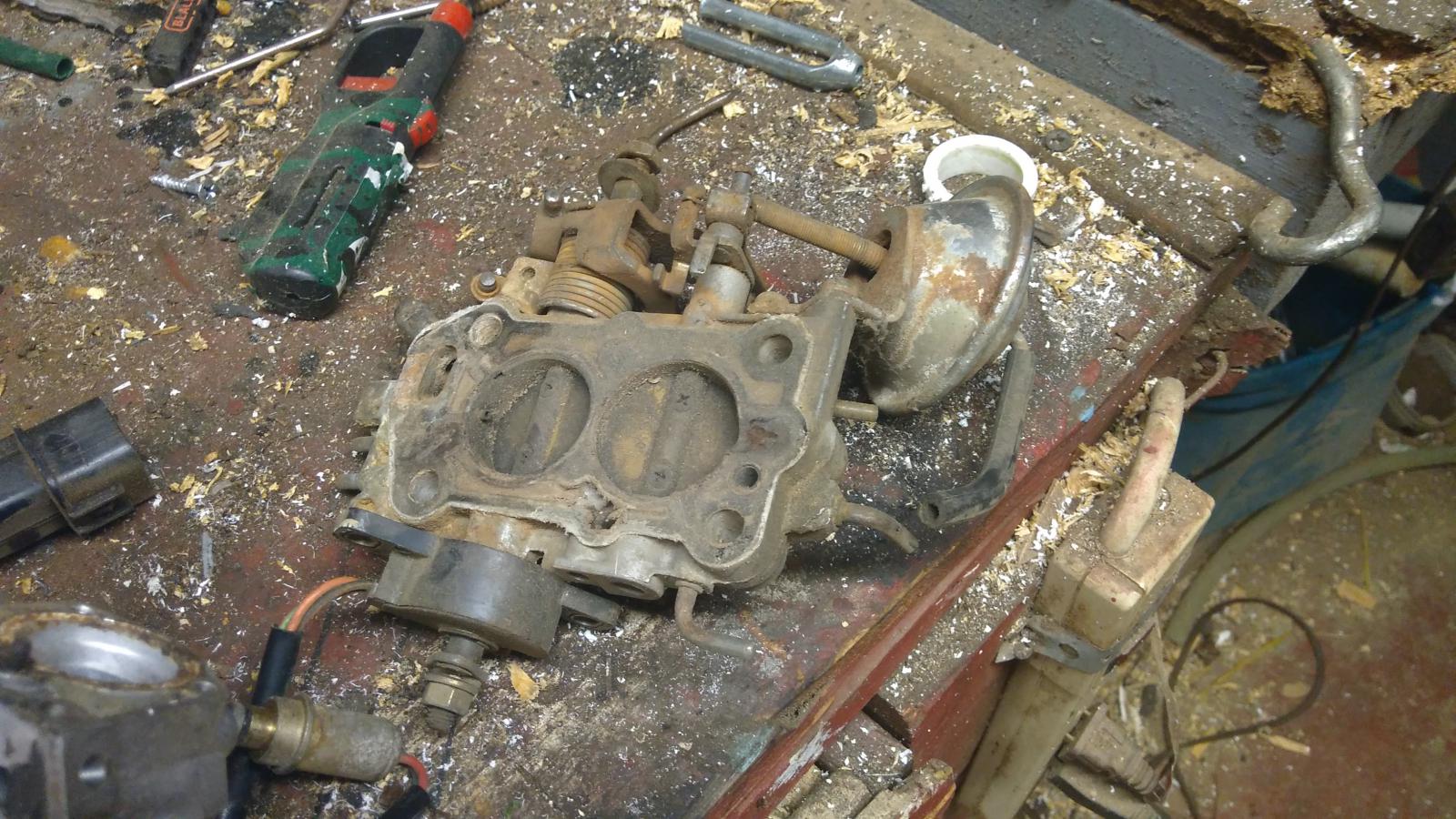

i have this carb that i took off my 1988 dodge ram sport 2.6l about 2 yrs ago a guy was supposed to rebuild it but he had mental issues i like to have never got back most of the carb here is what i have left.
(email me or pm me)
if you or anyone else can use any of this i don't want to break any rules by posting a price.
