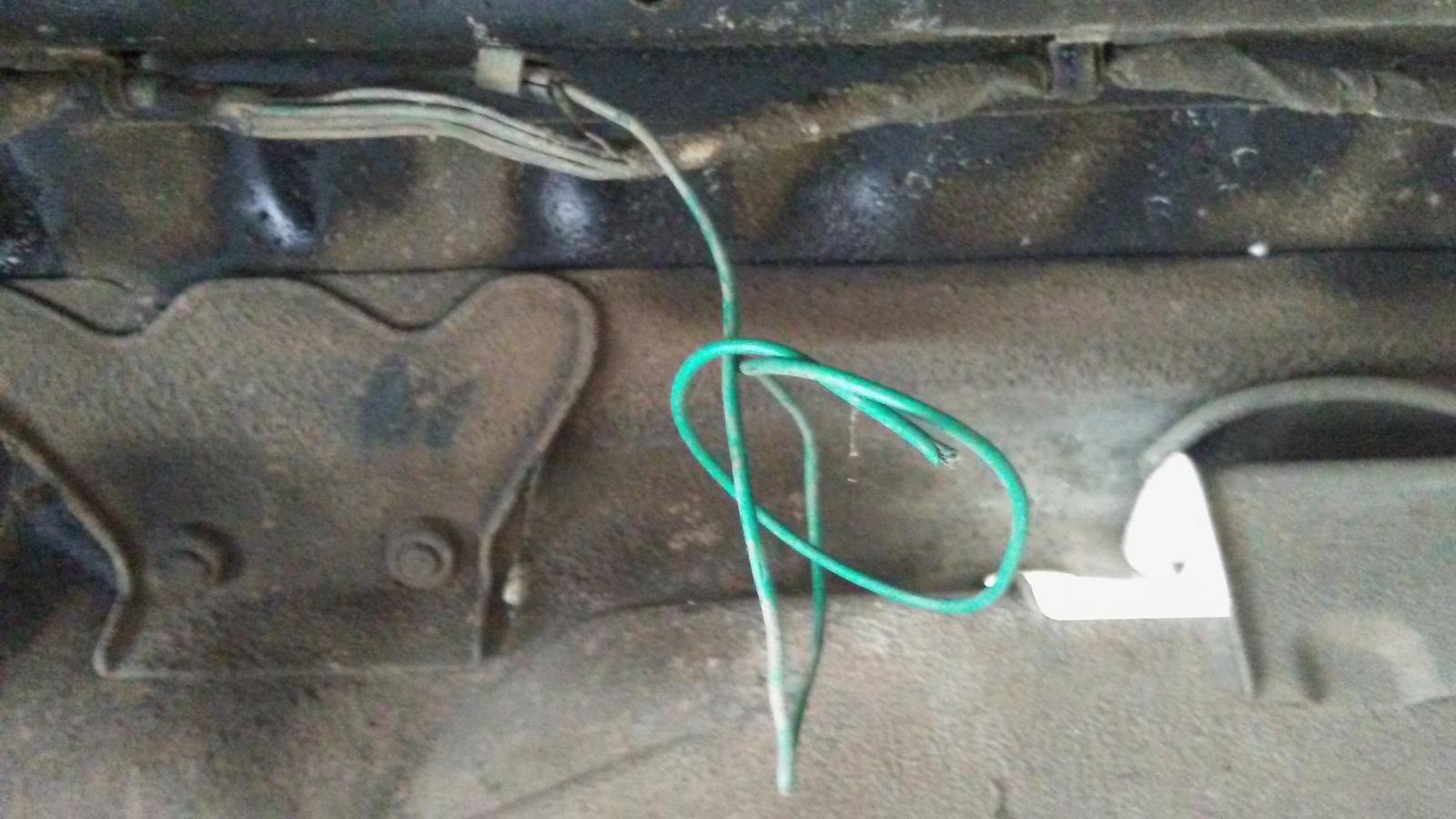

Okay, so the rear right brake was working before I started messing with the bumper. I somehow ripped or disconnected a green wire while removing the rear bumper. I was wondering where this green wire goes to?
Attachment 18679

That green wire is meant to be going nowhere. There's a crimp connector bridging it into the factory loom. Only way to find out what circuit it's attached to is hook up a test light or a multi meter and turn on your light circuits (reversing lights included) and see which one makes the wire live. Might be the license plate illumination which runs off the parking lights or an extra brake light or reversing light. I'll put money on plate illumination.
...sometimes the simplest explanation is overlooked as you expect the worst (some call it 'pessimism', others call it something far more offensive... 'reality') Glad it was an easy fix :)
