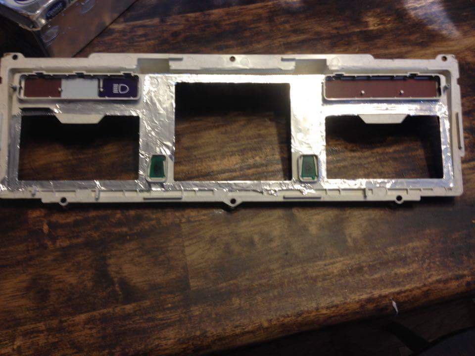

Attachment 18456just super glued aluminum foil to the back haven't had a chance to test yet, fingers crossed

It didn't really help much just so everyone knows
