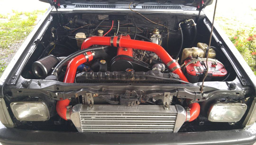

i was most pleased with the difference in power.. then i started fiddling with the injector pump... increase fuel and boost pressure with a manual boost controller... all this time the set up was non intercooler. egts started going up exceeding 1200F at 18psi of a stock td04 turbo...
Eventually i purchased a front mount intercooler and a universal piping kit from ebay. all was going well... my motor was crossing 500,000kms.. yes i do alot of driving. compression was down began getting alot of blow by. so i torn it apart, replaced the rod bearings piston rings and added a MLS head gasket. all OEM seals etc. and this is where i am now...

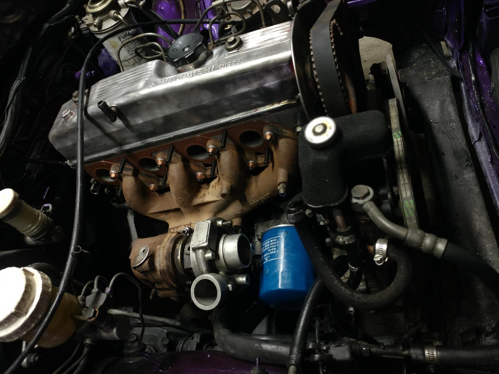

My factory turbo gave out recently and i am currently building a twin scroll manifold to put in an evo 6 TD05 16g turbo.
Attachment 18261
any question/criticisms are welcome.
