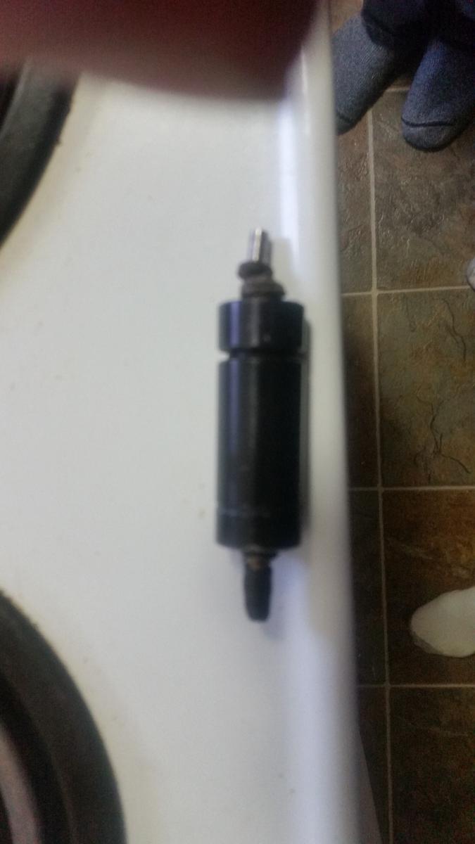

This part failed on me (photo), which in turn I have no clutch pressure.
Not sure what it's called, dealer didn't know, lordco didn't know, and all the gas ones I looked at the wrecker dont have this part.
It's on the line between slave cylinder and master cylinder, but on the master side. Attached by a little pin to the L shaped piece coming out of the firewall.
Some kind of pressure regulator ? Can it be bypassed? Or does anyone know how to find one?
Thank you!!!!
- Attachment 18193Off a Ranger with the 4d55.

Got a clearer picture. Looks like your phone auto focused on the socks, lol. I've got a clutch pedal setup out of an 84 mitsu and I don't think it had this. I'll look but pretty sure it's just a line straight down to the trans.
Only reason it stopped the clutch from working is because it busted at the connection and sprang a leak in the line. And I looked at the wreckers but the gas ones dont seem to have this part, and the only diesel i could find it was gone with the tranny. Dont have a better picture at the moment...Thanks for looking!
Bypass it. The worst thing that could happen is you loose some time messing with it.
That is not a factory part. Looks like some hill billy worked on the truck. There was only a master, pipe an hose, and slave. PERIOD
id love to see more pics of it though. But knowing ford, they probably added it lol

Kinda looks like it's made to the line
That is a pressure check valve.
OR
It's a CDV clutch delay valve that will slow down the release of the clutch.
It holds some pressure to keep the auto adjustment for the clutch.
OR
It will slow down the release of the clutch. When they go bad they will alow the clutch to slip.
They were to allow the clutch to engage at a standard rate and stop drivetrain shock.
Call these guys and see if they can find it. If you look on the old one there should be a PSI rating on it.
I would guess no more then 4 PSI.
You should be able to get rid of it with out any problems since I'm 99% sure it is a CDV.
