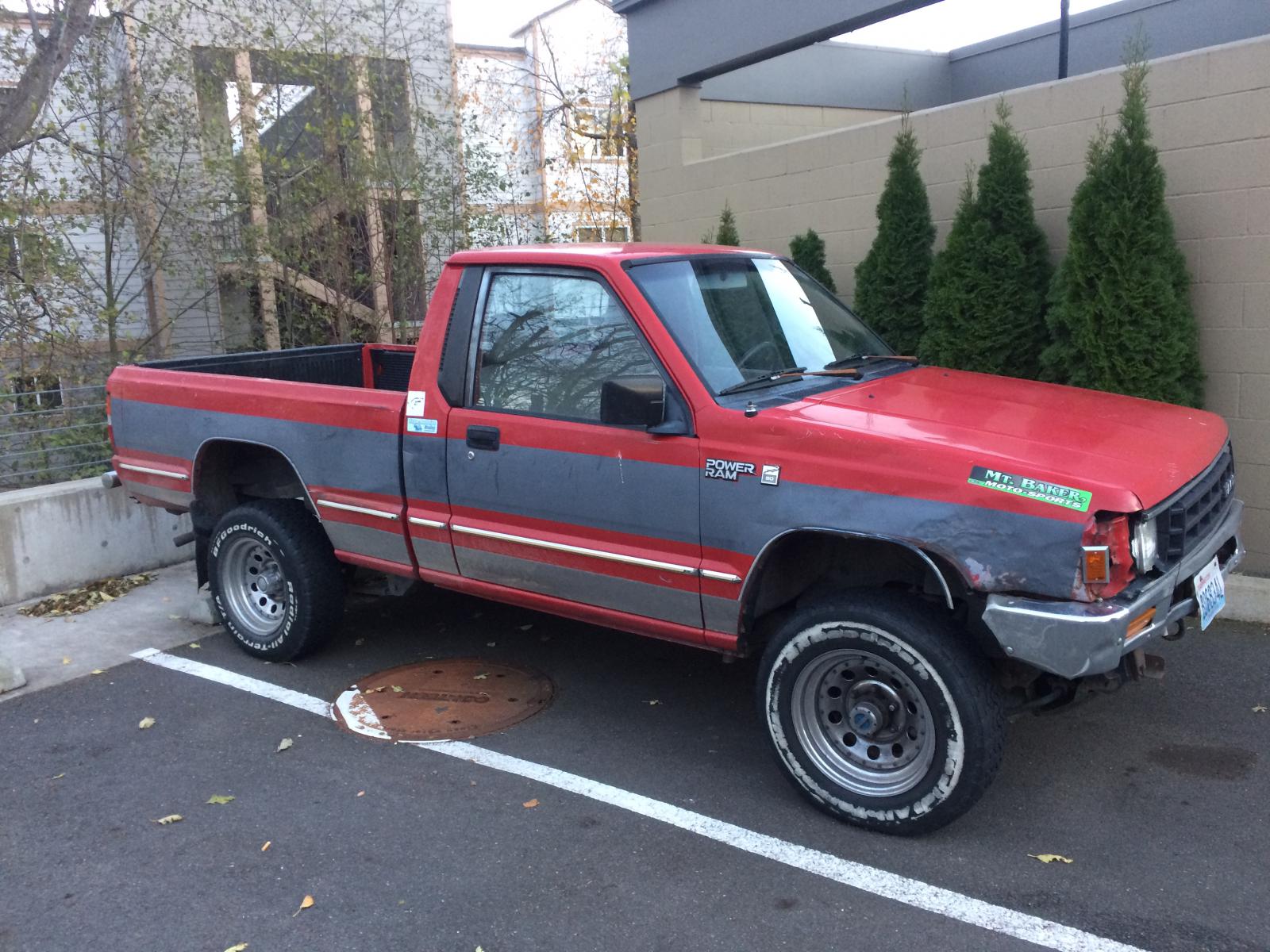

I just picked up an 88 Ram 50 4x4 as a project. Had to tow it because the tranny seems to be stuck in reverse. Haven't had any time to dig in yet, but this is what I know after towing it home, and wanting to see if anyone has any thoughts. Haven't tried engaging 4x4.
-Feels like it goes into 1st, 2nd, reverse and neutral, but it won't roll, and the reverse lights stay on. Shifter is very loose.
-It just dies if the clutch is let out, so I had to hold the clutch in for the whole tow so that the thing would roll... (just used a tow strap tow so needed brakes and steering)
-At one point it did seem to want to go backwards, but this was where it was parked with a wall behind it so I couldn't really test it out there...but that cement wall was calling her name.
Anyone had similar things happen? Should I waste my time rebuilding things or just get a new tranny to throw in?
Hoping to spend some more time this weekend and maybe get the tranny dropped out and see what things look like.
