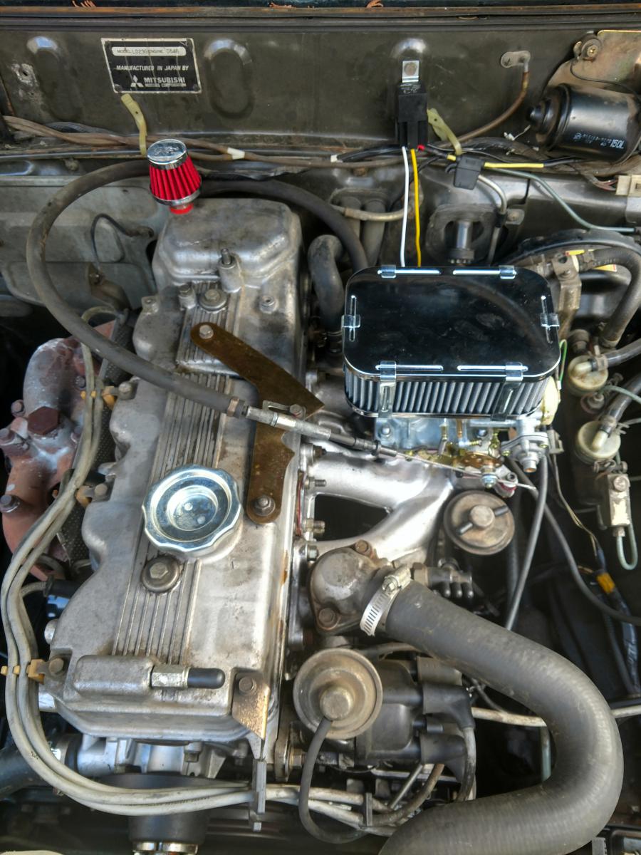

So I just finished the installation of a new Weber 32/36 carb and noticed that I mounted the throttle cable relocation bracket (boomerang) wrong. It's seems to function fine, but I am wondering if I may run into any long term issues with this setup? Attachment 17975
As long as the cable isn't being kinked anywhere and the throttle operation is smooth, I can't see there being any long term issue with the way you have it set up.
as long as you can adjust the cable to get full throttle, it is not an issue.
