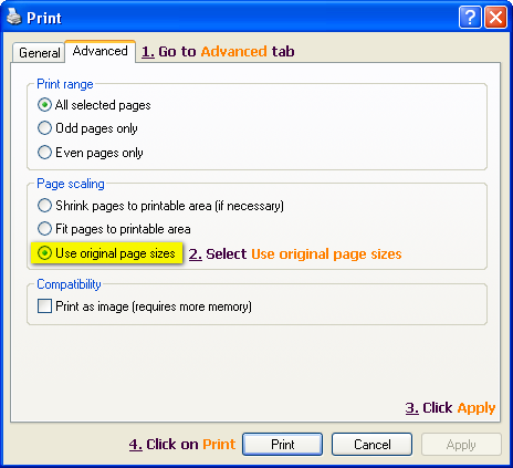

Tool is 1/4" thick. You will need to weld a 1" diameter socket with a 1/2" square drive to the end of the tool. With the provided template you can easily make this tool. (In my opinion)
Here is how to print the template properly (Windows XP):
http://www.mightyram50.net/vbulletin...id=17964&stc=1
