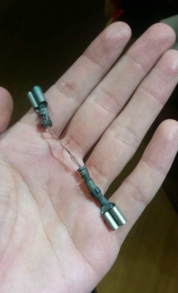

My Ignition Switch fusible link also looked like a complete mess, insulation completely smoked off. Based on the corrosion, the insulation has been gone for a while. The wire itself appeared complete though, and it ohm'd reasonably. I did build a new one using spades and link wire, but still no start. I got under the truck, and jump the main battery post to the ground post, and the starter spun. Should I be jumping 12v to the spade connector to properly test? I also hooked a jumper cable direct from the battery positive to the starter positive, but nothing.
