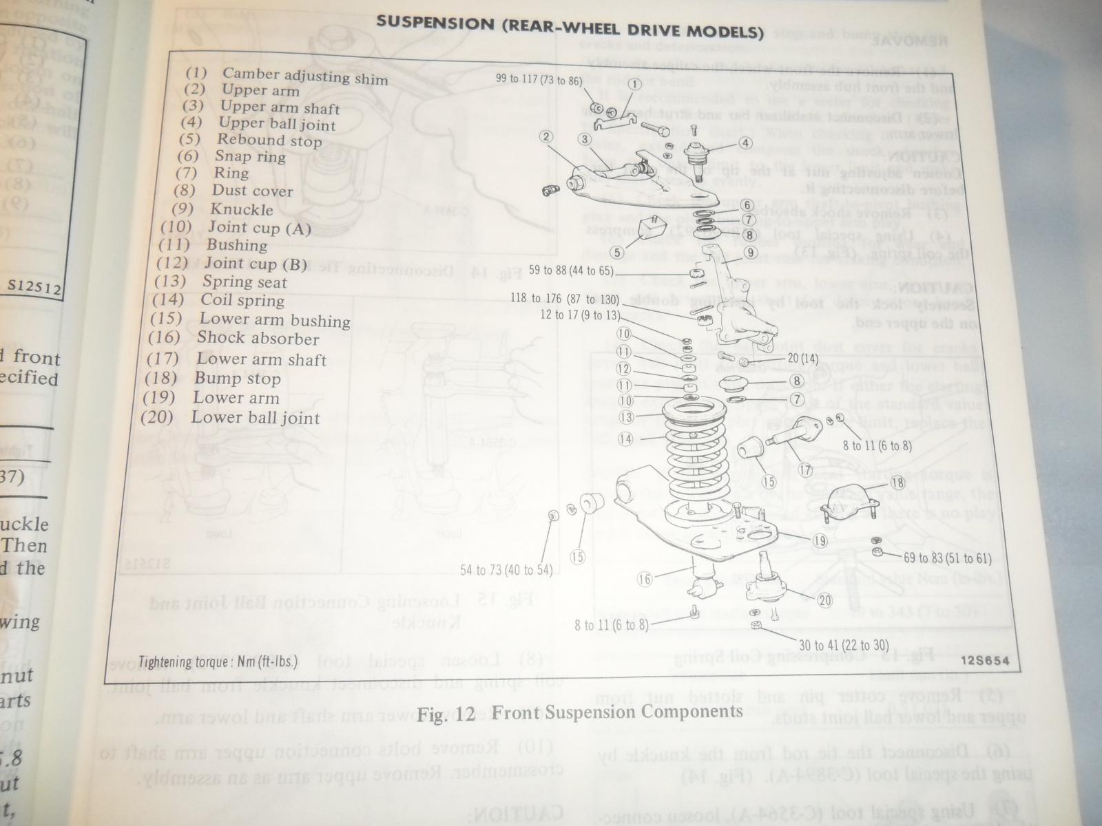

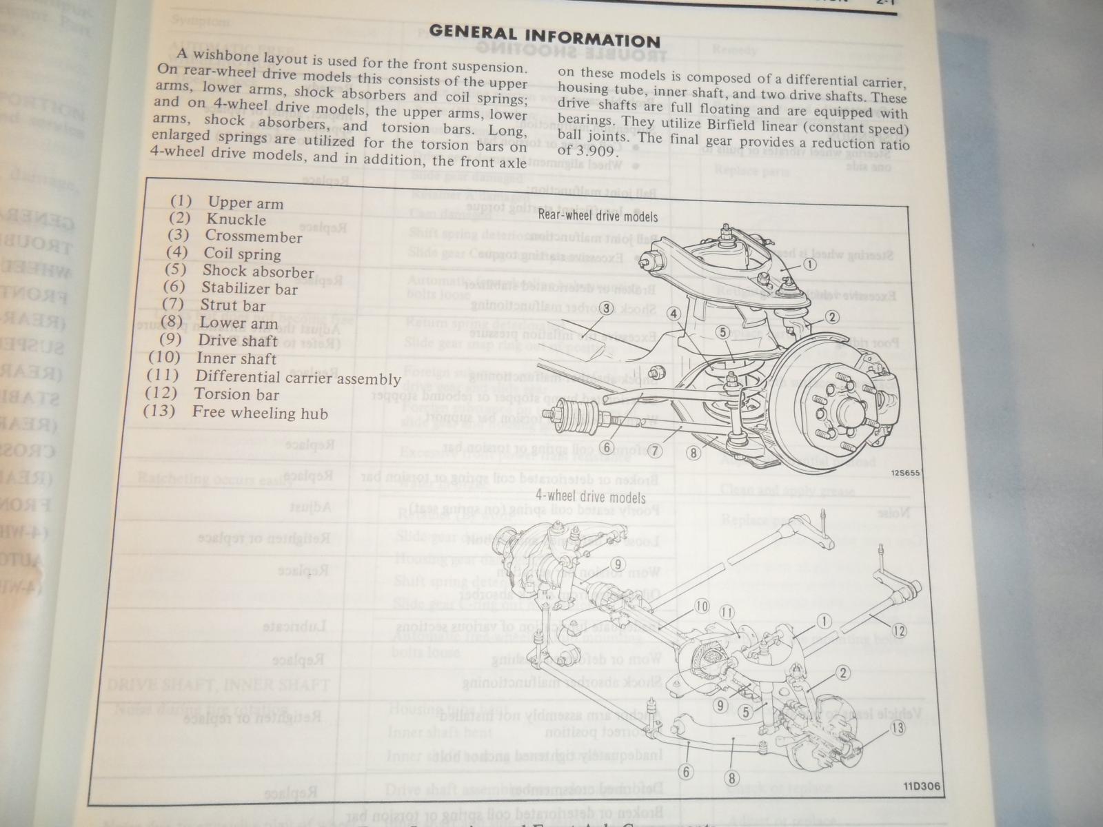

2 Attachment(s)
I finally made myself look through my FSM and I thought these two pages might be helpful as they show a spread out pic with numbered list of the part names. On the second pic there are numbers in this format "x to Y (x to Y)" this is the torque spec Newton Meters and Foot lbs respectively.
Oh yea do you have to have a spring compression tool? Or can I just take things apart?
Attachment 17894 Attachment 17895
