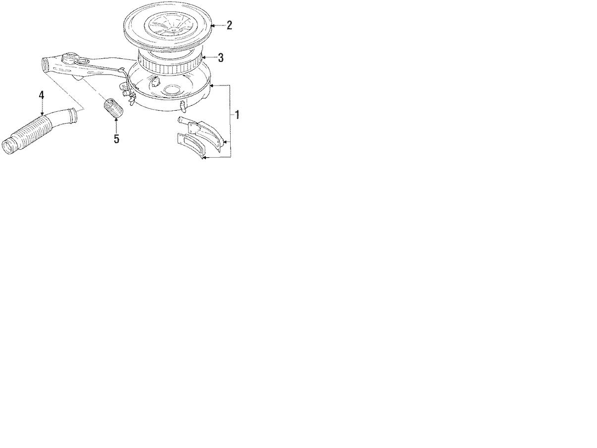

I got an OE air cleaner which I am trying to modify for the Weber carb. I'll report once I get it done. I need to be able to get filters for it if I can make it fit. I figure the round filters will be simple to find.
The part I want to find is number 1. It is the filter that sits inside that metal piece mounted on the side of the air cleaner. I can't find it on a straight air cleaner or filter search so I need the right name for that filter.
There is also a piece of fibrous stuff that catches oil from the valve cover hose. I need to know what that stuff is called.
Attachment 17857
I don't know what that's called either but I'll be watching this thread with interest. I want my OEM air cleaner on my Weber as well
Thanks that is the fibrous stuff Haruman. I got this part number from the MB dealer today for the filter. I haven't searched it yet- MD604887

I am probably going to get the side filter since it will be sucking air through that side. IDK where the hose from that side port goes maybe I'll be able to hook it up but even hooked up it required a hose?
where is the side port you are talking about located? need more info to help.
In the diagram in my first post it is one of the parts marked number 1. The last one at the bottom is the replaceable filter.

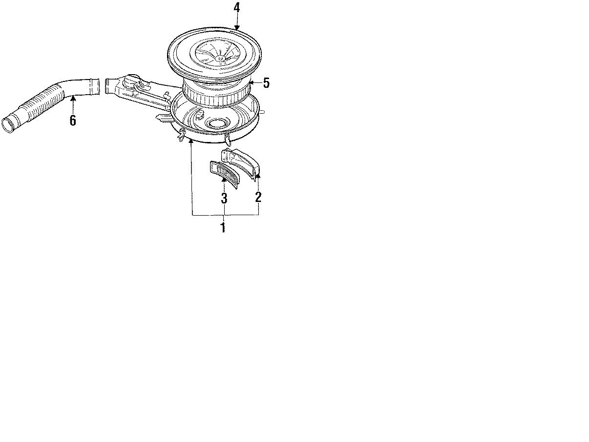

1 Attachment(s)
OK that PCV breather stuff is basically the same stuff the kid at Knecht's showed me today. I'll look and take pics of my valve cover just to see if you can see anything. My PCV is on the top front and connected to the base of the carb and the top back of the valve cover I think is the breather that connects to where this fibrous stuff goes at least by the way the hose that it came with is shaped.
Here is a better diagram. Number 3 is the filter I am trying to get. I may see if I can get a cap for that hose connection removing the need for a filter there. That filter at the link costs more to ship than the price of the filter same at other online MB sites. Only one prices delivery at $9 and change.
Attachment 17864
Pennyman I got the LTD breather stuff and cut it in half to use. $4
I found that the Fram part number for the Breather Filter is CA6594 and a search brought it up on RockAuto for less than $3! Seems like it has to have this filter to seal as I noticed the rubber edges of it seal the top and bottom of the encasing steel otherwise it would be sucking air/dirt through there.
