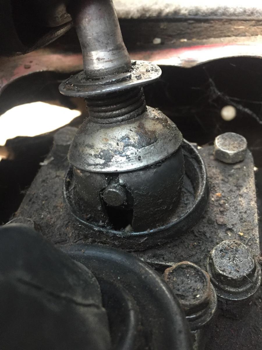

Hey guys! So i had a mechanic tear down my shifter because it was leaning a bit when i would shift. I'm attaching a photo, but my question is what is the part number? or maybe can i buy an entire stick shift? does it have to be salvaged or does someone carry them? I'm having a hell of a time looking this up and I'm a little mechanically challenged.
My friend sent me this photo and don't laugh at me but i cant even see whats wrong with it. I dont even know what hes talking about.
Any help would be appreciated! Thanks Fellas!
Attachment 17848
the black ball that is below the inverted silver cup is split, and causing the shifter misalignment. That part may be available from the dealer, or there is a place in Australia that sells them - try looking in our parts locator programs in the manual thread.
Ahh ok so the split at the top of that pin is what's wrong with it?

The boot is missing too and I cannot believe it is not leaking oil like a pig. The dealer can still order new shifters. Much easier. OEMMITSUBISHIPARTS.com like $150 for the complete shifter
