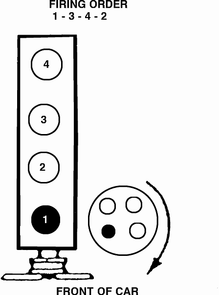

1 Attachment(s)
4
3
2
1
front of engine
OO
OO clock wise(sorry I couldn't insert image.)
never mind I guess I did. lol

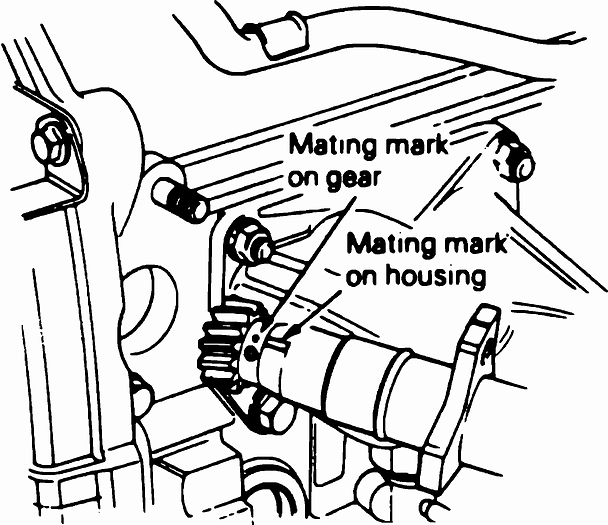

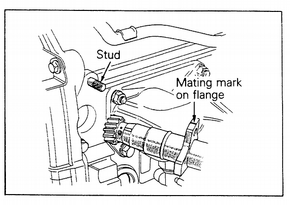

1 Attachment(s)
INSTALLATION
1. Rotate crankshaft until piston of No. 1 cylinder is at top dead center on compression stroke.
2. Align mating mark line on distributor housing with punch mark on distributor gear, Fig. 5.
3. Install distributor onto cylinder head.
4. Align mating mark on distributor attaching flange with center of distributor flange stud, Fig. 6.
5. Install mounting nut, then install vacuum hose(s), wiring harness and distributor cap.
6. Check and reset ignition timing as necessary. Refer to ``Tune Up'' for procedure.

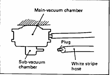

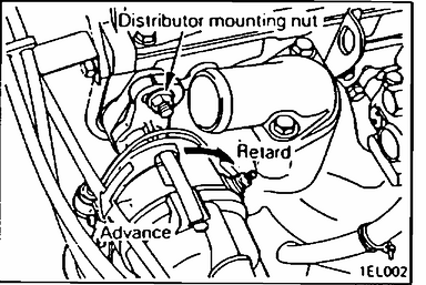

2 Attachment(s)
IGNITION TIMING ADJUSTMENT FOR 2.0L ENGINE Adjustment conditions:
Coolant temperature: 85 - 95~C (185 - 205~F)
Lamps and all accessories: Off
Transmission: N (Neutral) Set Parking Brake
1. Connect tachometer and timing light.
2. Start engine and run at curb idle speed.
Curb idle speed rpm
First 500 km 700 +/- 150
(300 mile) +/- 100
After 500 km 750 +/- 100
(300 mile)
3. When checking the basic ignition timing at high altitude [altitude of 1200 m (3900 ft.) or more], disconnect the vacuum hose (white stripe) from the sub-vacuum chamber of the distributor and plug the hose end. Cars for 50 states and high altitude cars for 49 states excluding California
4. Check basic ignition timing and adjust if necessary.
Basic ignition timing: 8~ +/- 2~ BTDC
5. To adjust ignition timing, loosen distributor mounting nut and turn distributor housing.
6. After adjustment, securely tighten mounting nut.
7. When checking ignition timing at high altitude, connect the vacuum hose disconnected in Step 3 to the original position before making sure that the ignition timing has been advanced to the actual ignition timing. Cars for 50 states and high altitude cars for 49 states excluding California
Actual ignition timing: 13~ BTDC
