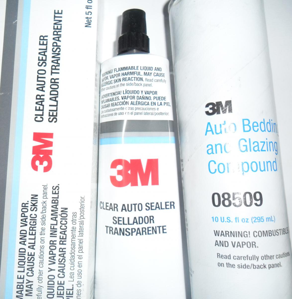

The instructions they send says to use 3M glazing compound (96-8509-96) on the area just outside the pinch weld. and then they say to use 3M auto clear sealer (96-8551-96) between the rubber and the glass on the outside after it is in.
