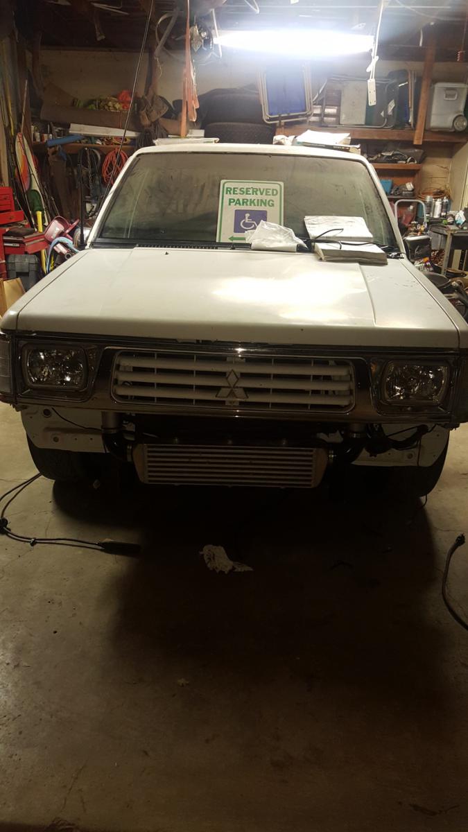

Are you wanting lit up pics? I just swapped to H4 diamond cut housings with decent H4 bulbs and it greatly improved the lighting up front. I plan to do a HID retrofit sometime in the future, but who knows when that'll be.
Attachment 16024
Lights off please. I like those. Clean, bright and allow for greater visibility.

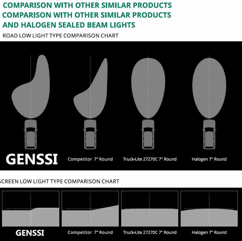

The Attachment 16394 company seems to have a good line of headlights. Pricey a bit for my taste, but they have some futuristic looking creations.
Attachment 16395
This is their claim in the headlight world. But as I always say, check all available types and review review review, before purchasing.
Their claim looks purely speculative - and are they specifying left or right hand drive lamp assemblies? You can manually adjust your headlights to generate that projection pattern but I've always dialled my headlights in for high beam depth with a parallel focus point (I never actually use high beam ever but I don't want to blow anyone's head off with an over adjusted headlight). A full set of 6x4" H4 dual headlight assemblies are on my wish list and I'm between choosing straight H4 semi sealed or something a little more fancy like LED rimmed headlights...

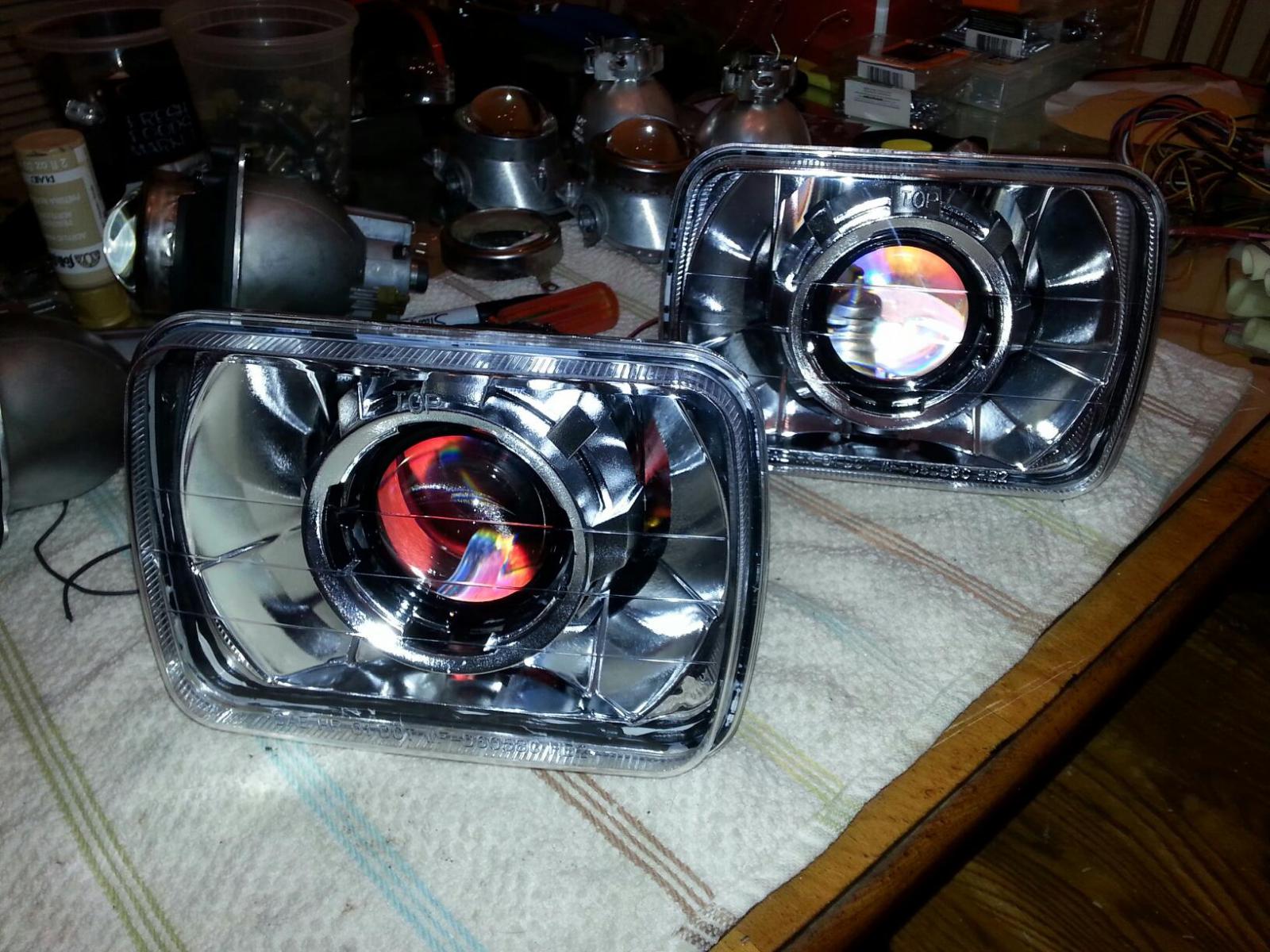

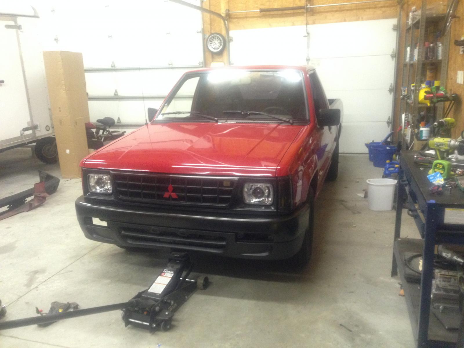

Here are mine. Rx330 retrofit in some pilot housings. Projectors are modified with clear lenses and bi-xenon shields. With oem phillips ballasts and 4300k bulbs, the low beam output is some of the best I've ever seen.
