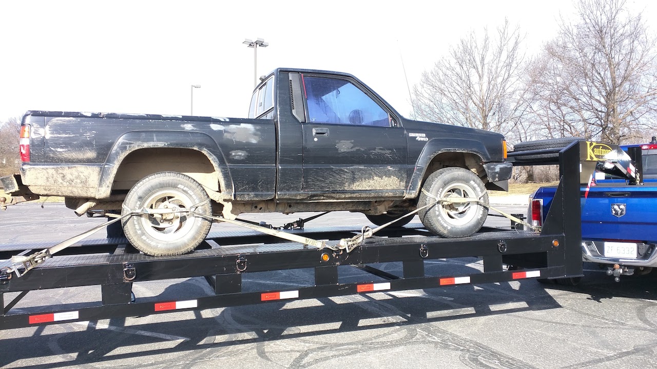

After nearly 4 months of searching, I found this poor bastard on eBay. So I took a gamble and had it shipped up from Arkansas. I feel like I just adopted an abused dog :lol:
It's really, really rough on the body and interior, and it took a pretty solid hit to the right front corner, but it was put back together fairly well. The damage was almost entirely isolated to the cab. The frame is basically untouched and aside from some surface rust, there's no rust or rot anywhere on this truck. It's got AC and an LSD. The AC doesn't work, but at least I won't have to track the parts down to add it.
Attachment 15947Attachment 15948Attachment 15949Attachment 15950

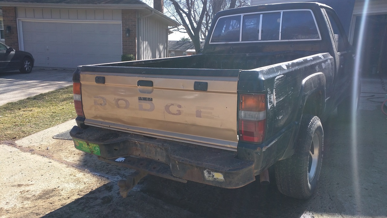

Just taking a power washer to it cleaned it up considerably. I've already replaced the smashed tailgate and broken light with parts off a gold Ram 50. The horrible purple window tint is now gone, I've replaced a bad flex section on the exhaust downpipe, and it's got all new brakes and belts. The last thing I need to do is replace the windshield so it can make it through the stupid Missouri safety inspection, in order to get the title transferred over.

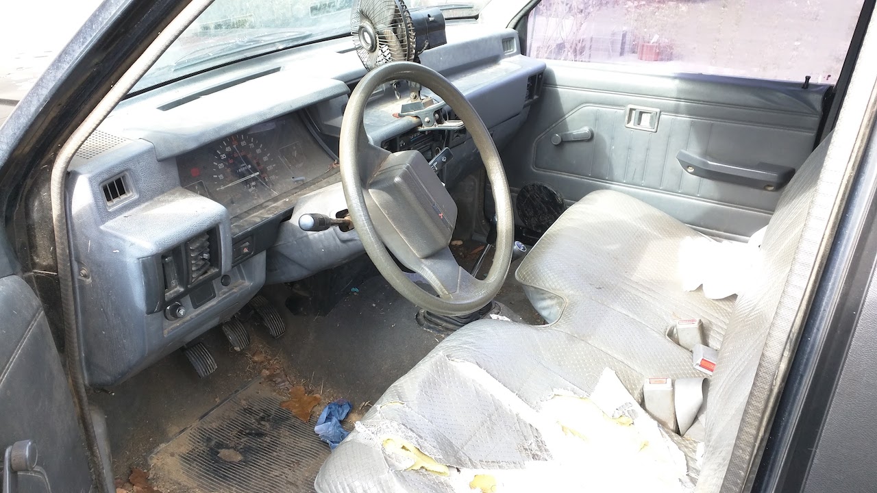

It's light gray and badly sun damaged. I'll paint/dye it later.
Doesn't look that bad. Some Armor All should clean most of that up. I am surprised how good your doors and door pulls look.

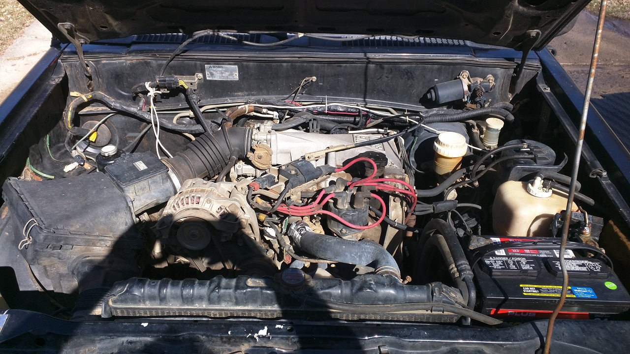

Good find! That V6 would be awesome to have... i was excited to find the one i did but that little 4-banger is TIRED! itll do for now, but id sure look into swapping in a V6... im assuming that transmission is conpletely different right?
Yes the V5mt1 trans is what you will need to put a v6 in yours too. Otherwise it won't fit.
Tip for rejuvenating interiors - stay the hell away from armorall. It evaporates and fogs up the glass. Give it a really good clean, buy a can of cheap-ass tire shine and give the trim a really fine spray with it. Rub the stuff into the grain of the vinyl with your bare hands, and repeat. It might take 2 or 3 applications but it will go a long way to restoring the colour and plasticity of the trim. If you're gonna recolour the trim with a penetrating vinyl spray, don't use anything to treat it first. Just give it a huge clean with something like pre-mixed sugar soap in a spray bottle - taking the entire interior out will make the end product look pro and you'll be able to get all the crap out of every corner and gap.
p.s. good stuff for taking on this truck project - save them, drive them, love them! :thumbup:
I plan to paint and dye the dash later, so I'll skip the chemicals for now. When I did my Stealth, I used Simple Green to clean the dirt, and then dish soap to remove any residues. It's held up extremely well despite being parked outside for several years.

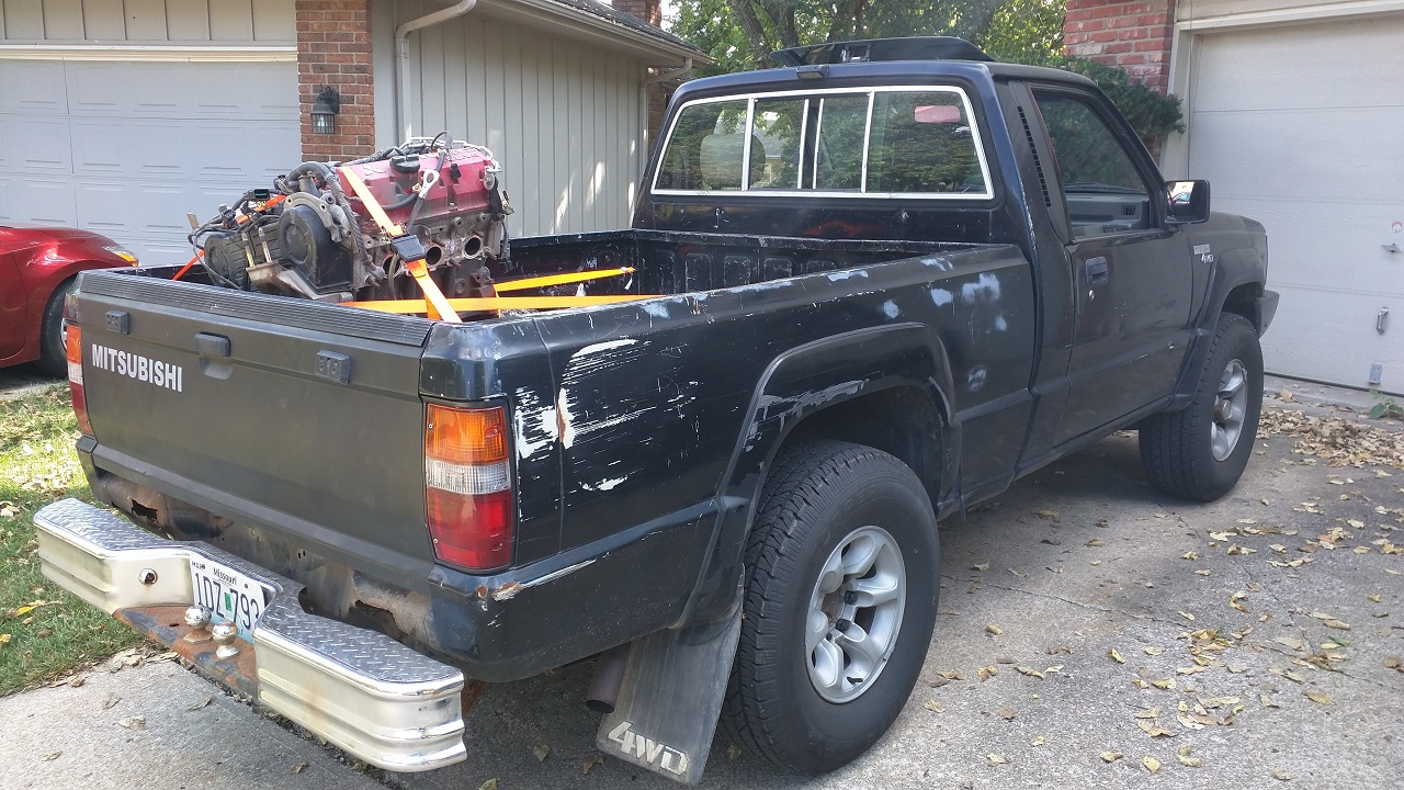

1 Attachment(s)
Yessss. 3.8 MIVEC for $150 :shock:
