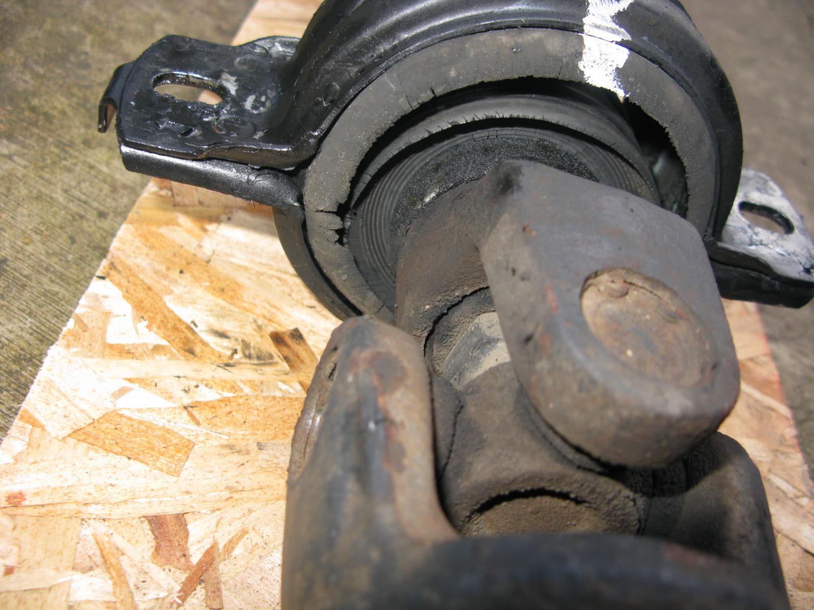

Had a super slow leak on the driver side front tire, turned out to be the rubber air filler thing I forget the name of right now. The tire guy I've been using for ever asked me why the truck still makes a clunk noise and I told him I still haven't figured out what it is! So he jacks up the back, wiggles the driver side rear tire and says "u-joints" and you better take care of that right away. Got the ujoints from the local part store & then started taking pics of under the truck and found this:
Attachment 15744
Yeah so it's a blurry pic but that rubber isn't supposed to look dried with missing chunks. I looked in the book & found out what that part was called & got one ordered from rock auto same day.

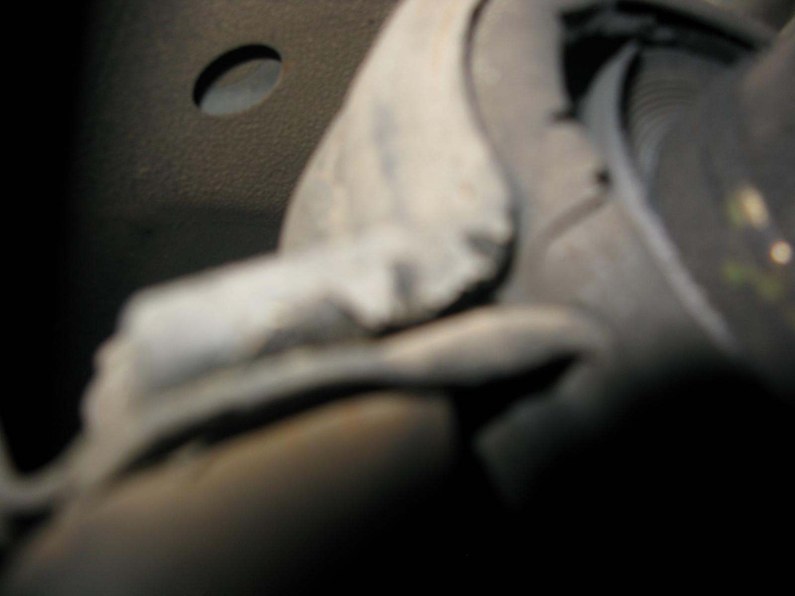

Attachment 15745
Hm, yeah that looks great, no? Guess that explained the clunking sounds. Oh, and the auto shifting gear handle vibration that was driving me crazy & made me keep checking the transmission fluid for no reason at all.
Okay so the vibration that my tire guy asked me about was the ujoint(s) / center carrier bearing. The 3 ujoints & center bearing are all replaced now, but I've only taken her up to 35mph so far - you know, just in case I messed up. I don't want to actually die if the bolts aren't tight enough. Waiting to see if I hear a weird sound or not & then will slowly take it up to 40, 45, 50, 55... unsure since I've never done a driveshaft until this last week. I did try my best to use the torque specs in the book though so should be okay.
On the upside the truck drives MUCH better now & doesn't vibrate nearly as much as before (duh I guess). People kept asking me if it vibrated over 40mph and I kept saying hell if I know, it vibrates all the time, it needs new shocks, blah blah I didn't even know there was a center bearing thing like that. Stupid new owner me learned a new lesson though :) and nothing actually broke off while I was being ignorant - thank goodness.
