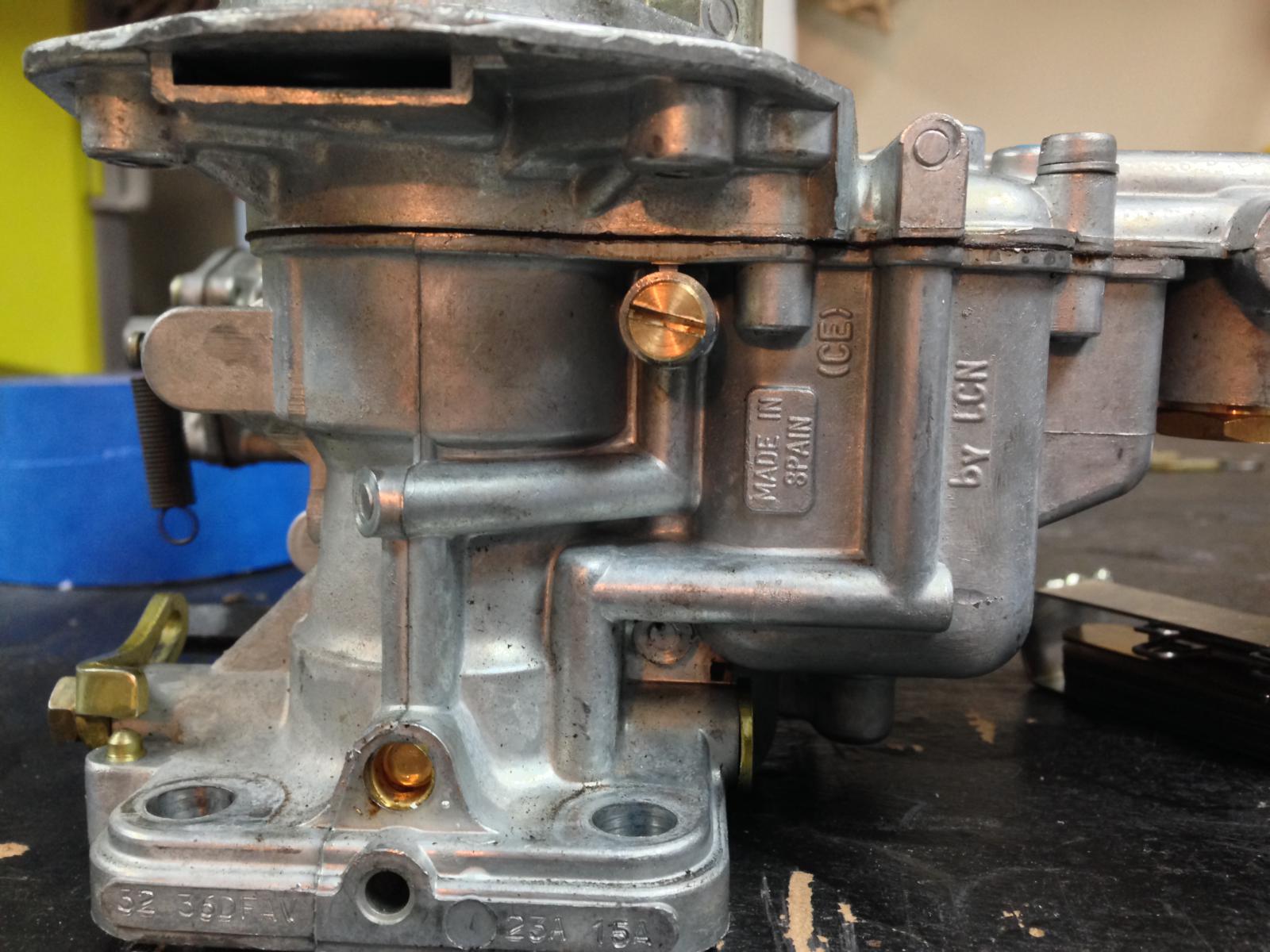

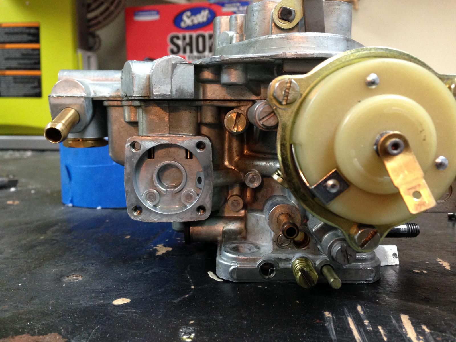

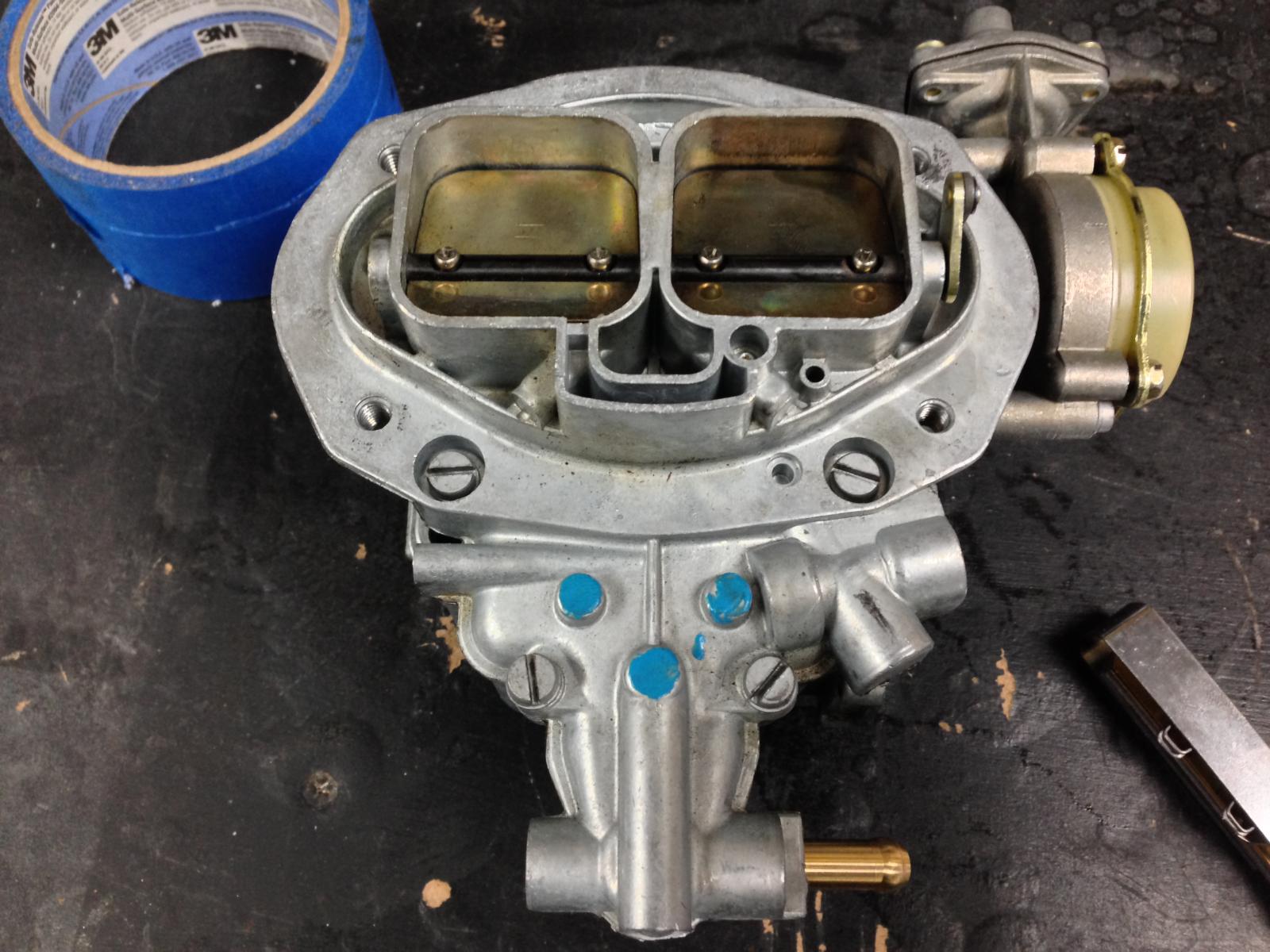

Been lurking here for a while and sponging up intel. Great resource mightyram50 is for anyone new and old to the mighty max. I've been working my way through the list of things to do on the mitsu. Got a little crazy with the stereo and sound deadening, never had any stereo before so why not. All fluid and ignition replaced. Did the weber 32/36 kit and thats what has been giving me fits. Could not get rid of an off idle hesitation which was also the throttle position pretty much all day.Jetting and base gaskets till I was blue in the face. Turns out to be a leak at the throttles butterfly shaft and then come to find I have the chinese weber (crap). Called Pierce Manifolds and the lady that answered helped me identify that it is indeed a chinese one. Ordered a new real weber right there on the spot, and then she gave me a few bucks off saying she felt bad. Awesome, Awesome people those guys.
