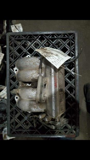

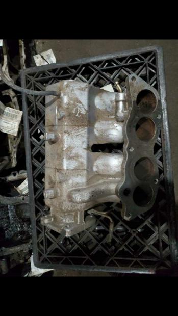

Had a cam ground. Bigger plenum on stock intake. Standalone tuned. Made a turbo header
