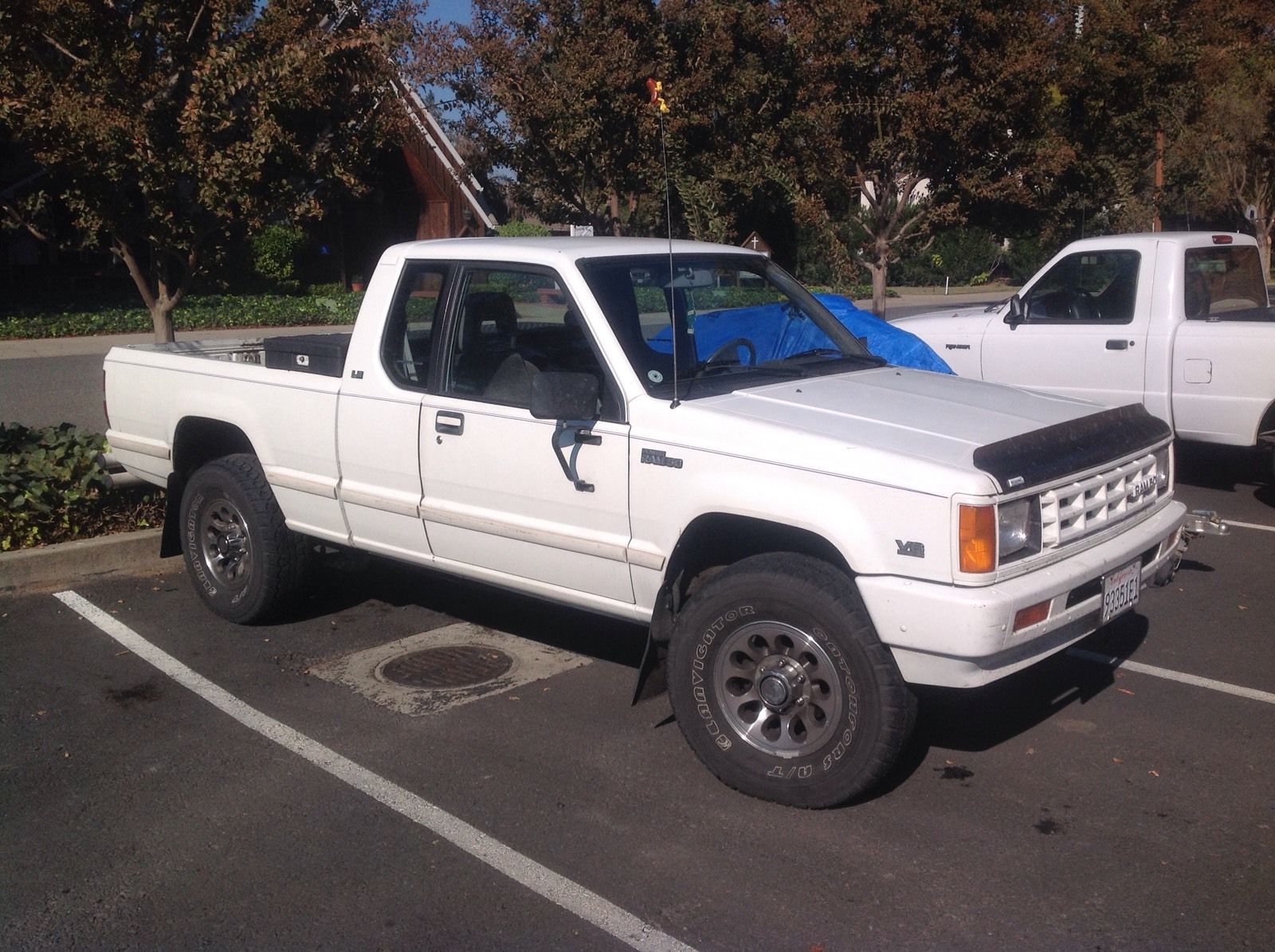

I think me and my brother beat you to this truck Chargerx3, we picked it up this last weekend.
Was this the one you were looking at?
Attachment 15609
It was located in Walnut Grove, California has a bad transmission.
Ah crap! I was going to pick it up this weekend. I hate you so much right now.
Not yet. Have you? The guy has had that auto rebuilt twice by so e dude on CL. Did you drive out from SD to pick it up?
Yeah i sourced one the same day we bought it the truck, we got a J-Spec OEM Aisin 03-72L from a first gen Montero with the lock up torque-converter for it. Will be ditching the weak sauce Chrysler A500 "mini" torque flight and installing this one in the truck. it also has the 6 bolt transfer case configuration so it opens up the transfer case options in the future to many domestic ones as long as they are 23 spline.
Not sure I see the upgrade. Your a500 should be quite stout with a few mods. Even has the coveted overdrive. I would definitely keep it around. Can't believe you took it all the way back to south Dakota. That is a long drive.
The A500 is toast. The new Aisin 03-72L has overdrive and is a very low mile unit. I also got it for a steel and it came with lots of other parts for the 3.0 V6.
And the truck is currently in Southern California at my brothers place while we do the trans swap and all maintenance, The trip to South Dakota from California is nothing tho, I once took a flight out to New Hampshire, Connecticut to buy a 1999 3000GT sight unseen and drove it back to South Dakota. Took the GF with me and made a road trip out of the buy. Got love the Mitsubishi obsessions.
