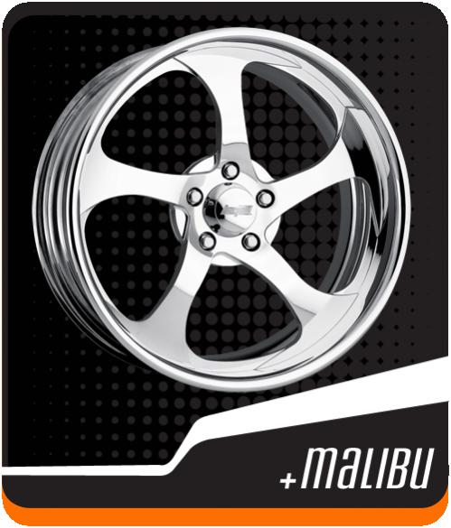

Thanks for all the help, after looking at cost and the wheels I would buy. I have decided to have custom wheels made. So I got the wheels below in an 18x8 that are being built for my MM.
Call me crazy, but the wheels cost more then what I paid for the truck, but then again my system was 3X the cost. LMAO
Attachment 15012
as a 5 or 6 lug and what backspacing?
Yeah custom billets are also a choice just most people don't want to spend that much cash. Nice looking rim, what brand are they? What offset did you go with?
Bon speed Wheels and they have done a few Mitsubishi. So they are doing an 18x8, 108 hub and -38 offset, 6x139 bolt. This is what they have done on all bagged vehicles.
I would agree they are expensive, but a toyota rear end at a junk yard was like $450. Then needed the driveshaft that I could use the end to modify mine and then weld it. Driveshaft $200. The wheels I was looking at was $800, so all in I would be at $1450.
Paid $1900 for the wheels, so paid a little more, but a lot less work. Priceless ;)
Yeah Bonspeed makes a good looking wheel. And you're right you paid a little more but less work and a better look in the end with a custom billet. Congrats on the purchase, post some pics when you get to doing some work.
