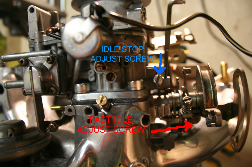

Hi cupcake, looks like you have been sabotaged by the dreaded Mikuni fiddler. I have a pic of the all alloy Mikuni/Solex carb but the screw locations are the same on the resin body Mikuni -
Attachment 14834
Reset you idle stop screw by winding it out until the butt end of the screw is no longer touching the linkage, then back off the fast idle screw a few turns (don't unscrew this completely as it is a biatch to put back in if you accidentally go overboard!). Now set your idle stop screw by winding the screw back in until it touches the linkage. At this point you start the engine and adjust the fast idle screw until it rpm's reach about 900 rpm. Next is the air/fuel mixture screw (the shiny brass screw in this pic - it's in the same location on the resin body carb) - while the engine is still running wind the screw in until it tries to stall out, then wind the screw back out about 1/2 to 3/4 of a turn. If it makes no difference it might be an indicator of an air leak somewhere in the carb.

Do you have a better picture?? I can hardly see the words lol
Never mind, I got a clear view of it lol. Now where is the mixture screw????
Hint : click on an image to make it block out the sun :lmao:If you take a look at the pic I've posted up you will see a brass screw in the throttle base plate just above the "S" in the fast idle adjust text - you will find the air/fuel mixture adjust screw in the same location on your carb. I might even suggest you take the screw out completely and clean it with some cloth/paper towel and reinstall it. If you have access to an air compressor and a blow down gun, give the mixture screw hole a quick blast while the adjusting screw is out as there can also be a blockage here (can of carby cleaner is just as good if not better). While you are at it test the secondary vacuum actuator for function. If it has a split diaphragm your engine will have literally no power over 2,000 rpm. Use the search function on the site - you will find this is a really common issue but easy to fix.
Ok I readjusted the carburetor and it runs a tad but better, but what is the screwbthat is right above the red arrow?????? I tried adjusting it and it did nothing
The fast idle screw is located at the bottom of the primary throttle linkage (my arrow is a bit dodgy but if you look closely you will see the head of the screw in the pic) That big gnarly screw that is above the arrow is an adjuster for the auto choke linkage and won't have any impact on how the engine runs under throttle.
