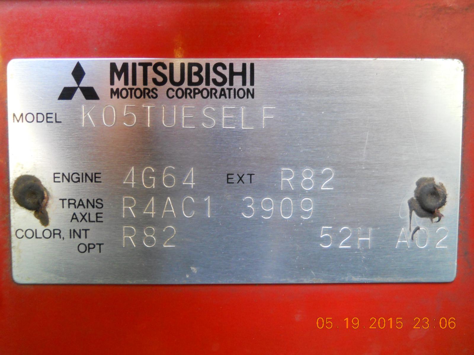

1992 MM Firewall Plate Decipher I need all information from the plate shown below. Thanks!!
Attachment 14074

It's a Mitsubishi "Long Truck" (K05T is Mitubishi's chassis code)
2.4L (4G64)
R82 is the paint code for that shade of red that year
R4AC1 is the A500 automatic transmission but it has a 3.909 rear end, which is unusual because I thought the autos all had 3.54 rear ends.
52H A02 is the option package which I'm still trying to figure out how to decode.
yea it's a weird one lol it was special ordered pickup truck I found the window sticker from 92 lol and it's a shortbed tho but it is single cab i guess the long truck code is a general term lol
PLEASE post a scan of the window sticker, that will help us reverse engineer Mitsubishi's option package codes.
"Long truck" is the term for a pickup truck in Japan.
