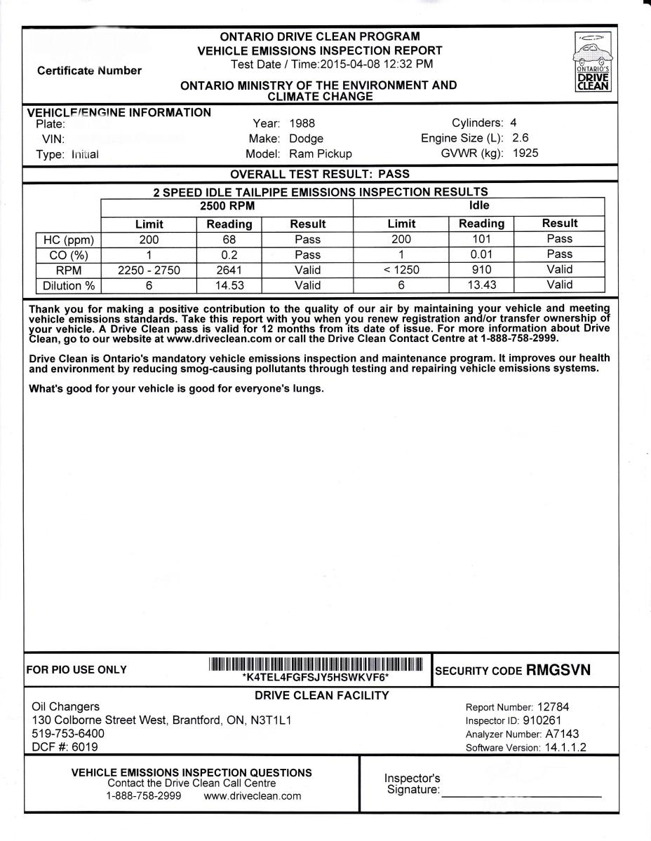

I took my 2wd in for emissions last week and it passed no problem. I installed the Weber last fall and have been concerned about the emissions test. I leaned it out to the max for the test and had a full tank of premium fuel. They use a 2 speed idle test with a sniffer in the tail pipe. Here are my results.
Attachment 13848
