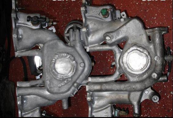

The problem with making high HP on these motors is the horrible and I do mean HORRIBLE intake manifold design, they literally choke the motor down, even with a bigger carb. That's what sent me on the path to getting the dual carb intake manifold for this engine in the first place. Just a wayyyyy more efficient design that flows way better

I'm not too sure our intakes are such a choke point, they are pretty much just open and straight shot to the chambers. Combustion chamber can't pull in enough air in a stroke unless something is shoving it in and or pulling it out like a turbo does. Need RPMs and CFMs. The carb would be more of a restriction then our intake on a 2 barrel application besides not able to run up rpms.

really? you wanna take one look at this thing and tell me it's a straight shot to the chambers? cause i see some HORRIBLE 90 degree dog leg bends and chamber that should be two separate paths being choked down to one. peak of performance airflow and CFM right there....

Attachment 13251 I still don't see a choke point, I see a direction change but not a choke (decrease size).
That intake you have is a 2nd gen, 1st gen has a less angle change and shorter runners.
Image above shows 1st gen on the left. Looks pretty good to me. Besides the EGR crap tubing in the cast.
