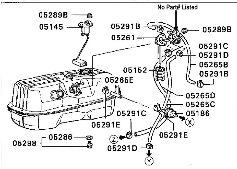

i have an 88 d50 . it has an external fuel pump. and the piece that goes into the gas tank and sends the fuel to the front is bad and has been discontinued does anyone have any idea where to get this part or have one they'd sell. its a triangle piece with 3 hard lines on it and it holds the fuel strainer in the tank and has the fuel supply line and the return line on it i don't even know what its called any help appreciated only had the truck 2 weeks and its my firs mini truck

Can this part be hot soldered using plumbers solder. Go to the plumber store and purchase a small piece of copper piping, solder it with a butane or map gas torch in place of the missing hose piece.
You can check RockAuto.com or maybe EBay.com. Rockauto would be the first choice to try. I doubt you will locate one there. Maybe some here has one or a run to the wrecking yard.
Attachment 12510
Thanks for the suggestion I'll try it and let you know how it goes
