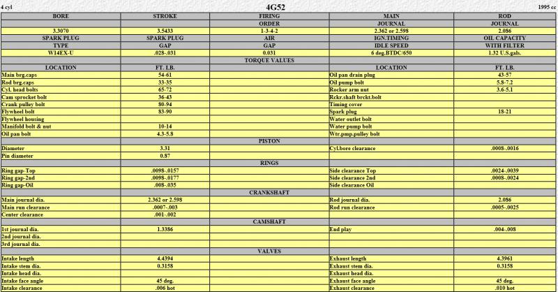

4G52 specs
Attachment 11559

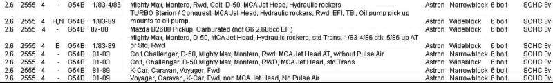

1 Attachment(s)
a magna carby should bolt straight onto your manifold. Chains can get noisy as they get older and at times they can make a rattle noise until the oil pressure pumps up to tension them.
Here is some Astron trany info that gives wide or narrow block
Attachment 11561
