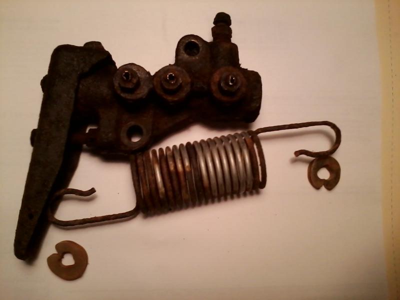

so...you press on the pedal & it depresses to "normal" level & it just doesn't stop til you reach the next town...Attachment 11537Attachment 11538Attachment 11539Attachment 11540...i had to replace valve & spring. try adjusting first & see if any change occurs....then bleed...also verify lines are not clogged/collapsed anywhere else.
