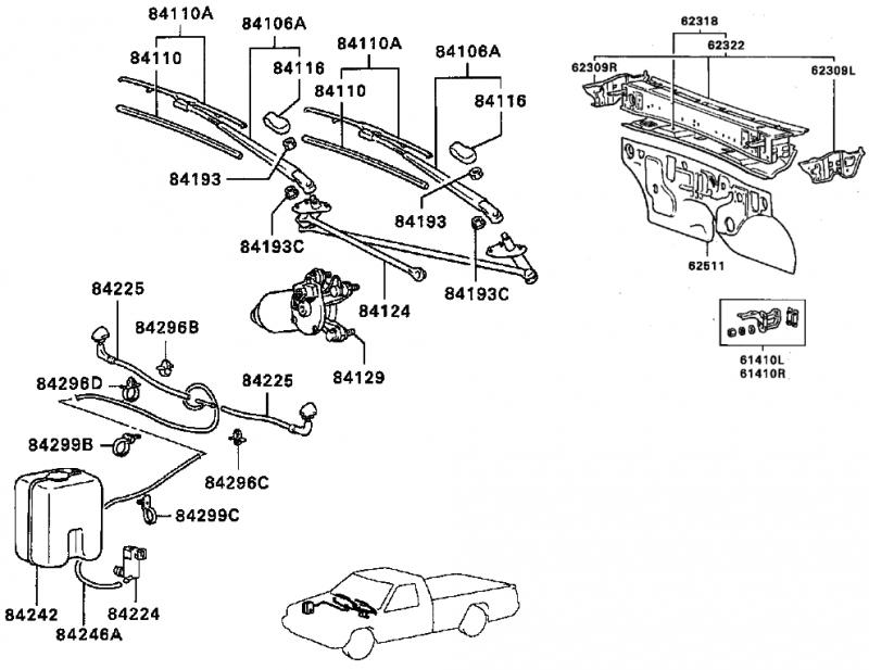

That stuff is like a wetsuit material for surfers and divers, craft shop, foam factory, hardware stores.. Got any diving shops close by? I'll install my ASA program and check for a part number.
Attachment 11297
Ok, the above image shows the parts used, or should I say available for this area. They show no dust cover thingy there. So, I would go with Roy's idea to make your own. Simple project for anyone and material is available.
