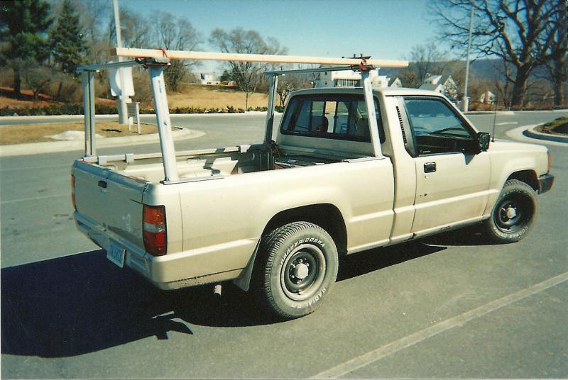

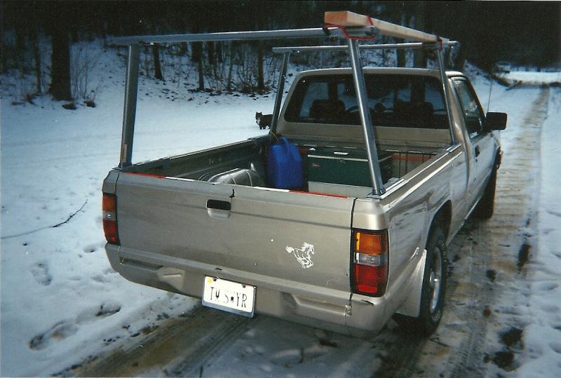

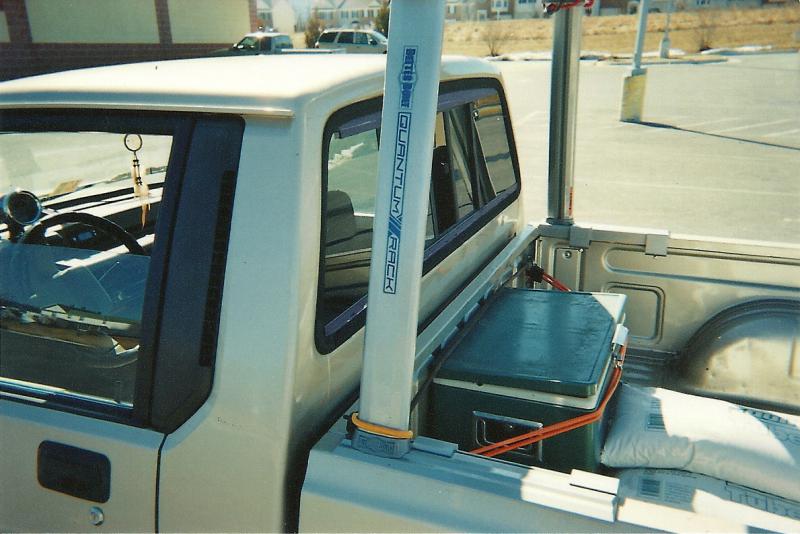

3 Attachment(s)
BetterBuilt (Quantum Rack) makes one that clamps to the bed. Mine works great for light duty lumber and ladder hauling. They retail for close to $300 but I got mine for $100 at Lowe's. I cut the horizontal bars to match the width of the truck.
Attachment 10692 Attachment 10693 Attachment 10694
