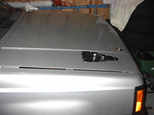

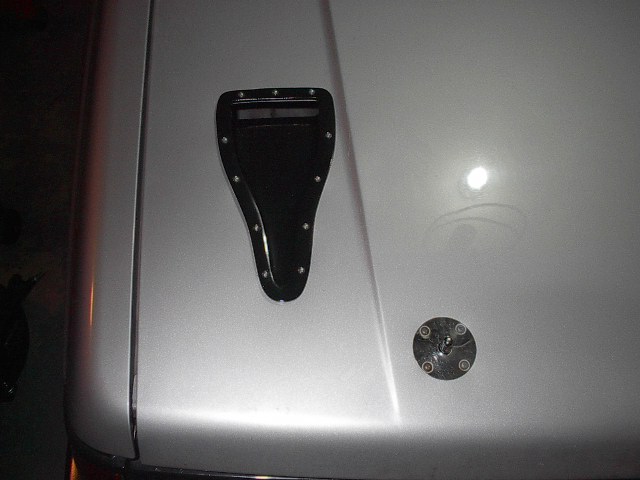

Attachment 10628
Attachment 10629
Looks clean! Good idea. Where did you get that?
E-bay, Actually got a pair of Fiberglass units, painted one black and sunk it into the hood with a jigsaw (laid down a bunch of blue tape on the hood first)
It's right over my Air intake. Obviously it would go on the other side for a Weber...
