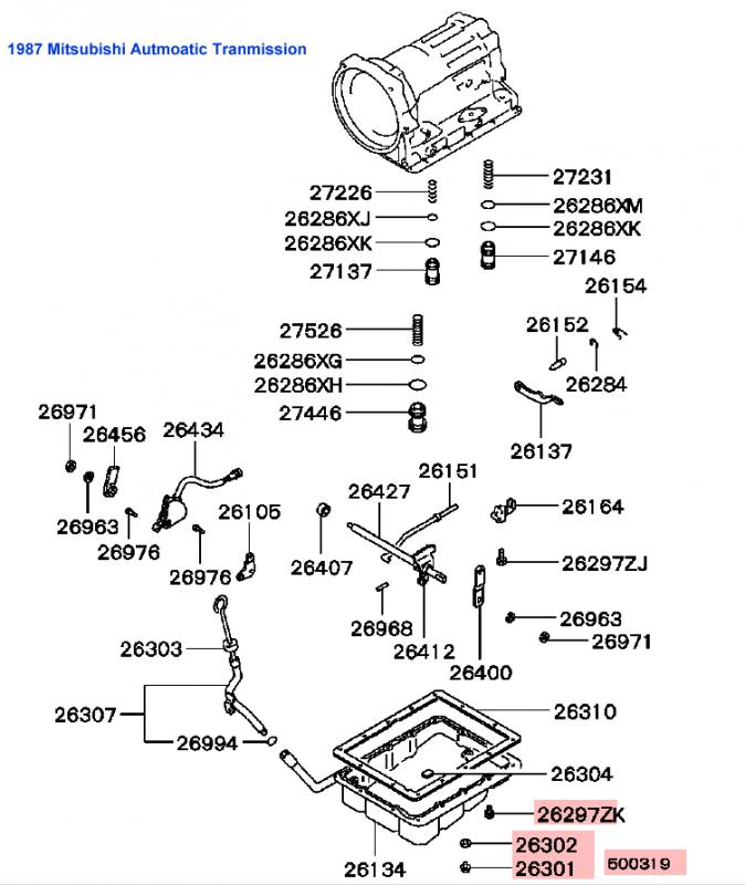

Attachment 10435
That is an auto pic Brad he has a manual!
