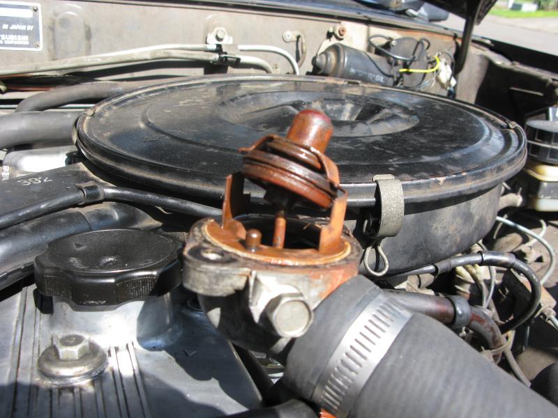

#5: Replace the thermostat and clean out the cooling system.
Overheating this engine will kill the head and your truck. Replace the thermostat, check the fan clutch, and check the water pump. It should move but have resistance when turned. Check the water pump. Grab the fan at the top then rock it toward the engine if it moves the pump shaft it needs to be replaced soon.

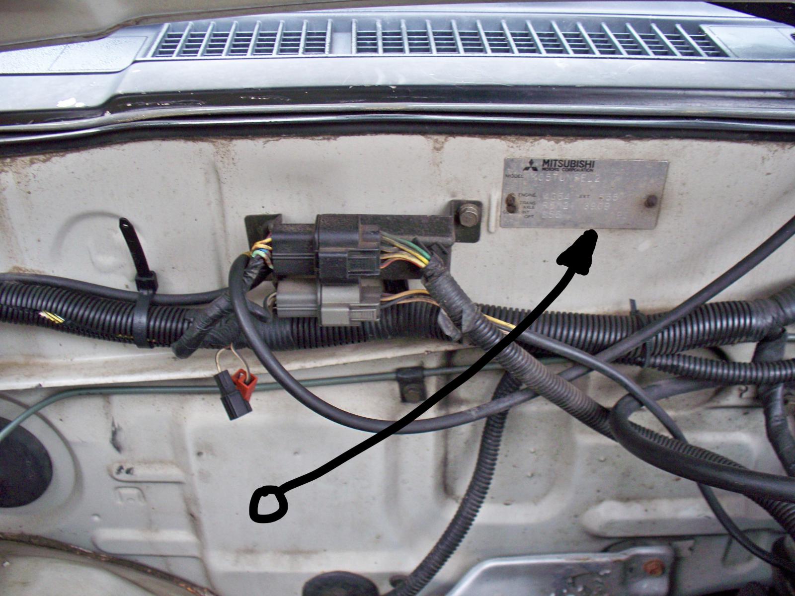

#7: Check and clean the ground on the ECU.
You will find the ECU on the passenger side of the truck under the dash. A bad ground can cause many problems. Find it and remove the ground wire from the body, use sand paper to clean it. The reinstall it if you like you can use some clear paint to protect it after you are done. Then do the rest of them under the hood.
