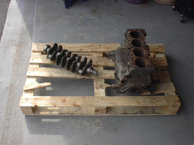

I tried to get a good shot of the lip at the top of the bore, it's pretty big. Also, every one of the pistons had a broken ring. I don't know if that is from removal over the lip or what, but the wear plus or minus the rings is definitely why the compression was less then 100 psi per cylinder. The lip is big enough to get your nail stuck easily.
http://i95.photobucket.com/albums/l1...ps4402739c.jpg
Knowing that my crank is probably going to have to be turned to be used, I decided to pull apart my spare block. The spare block came with the truck, but was seized up. Well, I unseized it, and I think I will clean this block up and as long as the cylinders can be cleaned, I will use this block. There is literally no lip at all at the top, and the bearings actually looked brand new as if someone put it together and then never ran it. So, everything will get replaced for peace of mind, but just thought it was interesting.
