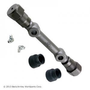

Large socket, one cap is right hand thread the other cap is left hand thread. just use either a 1/2" impact gun or a large breaker bar on the socket. If you can't get it loose going one way switch to the other direction.
you may only need to remove 1 cap to take out the cross shaft. Be sure to count the turns on each nut, as it is one of the front end alignment adjustments.

Those are press out bushings. you need a 10 ton press to remove them. what Pennyman and I are talking about is
Attachment 7203
these are what are listed for your truck. the first gen uses the same ones.

Yea I had bought some of those aftermarket shafts for my old truck back in the day but never got around to using them, figured those were the type that you guys were talking about.
