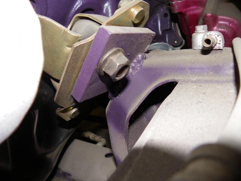

1 Attachment(s)
I Just made some mount extentions out of 1/2" x 3" flat bar welded to the factory front X-member.
Attachment 6284
But as mine is a SBF you might have to do something a little different.Hope this gives you an idea
kinda of what I was thinking. Might try to make my mount plates bolt in.
