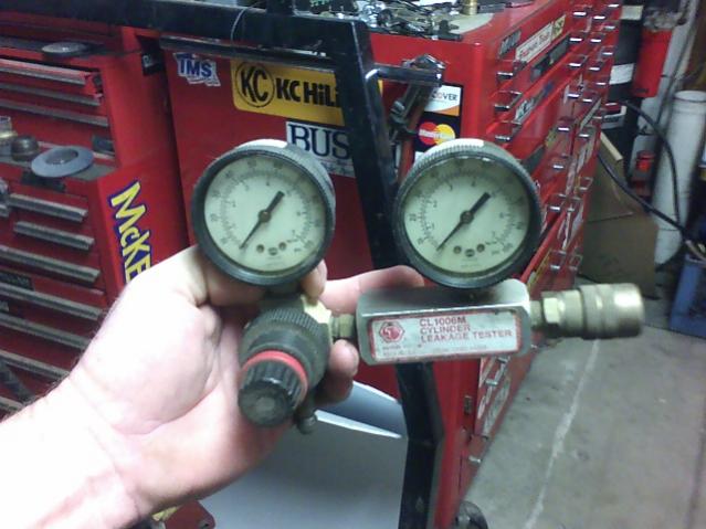

That was a coolant system tester. A compression leek test is what goes in the spark plug hole and then you can put compressed air in there to see where it's leaking. out the intake, exhaust pipe, crank case.
yea that's not the right type of test/tester, as camoit said you put compressed air into each cylinder and hear where its leaking to do a leakdown test.

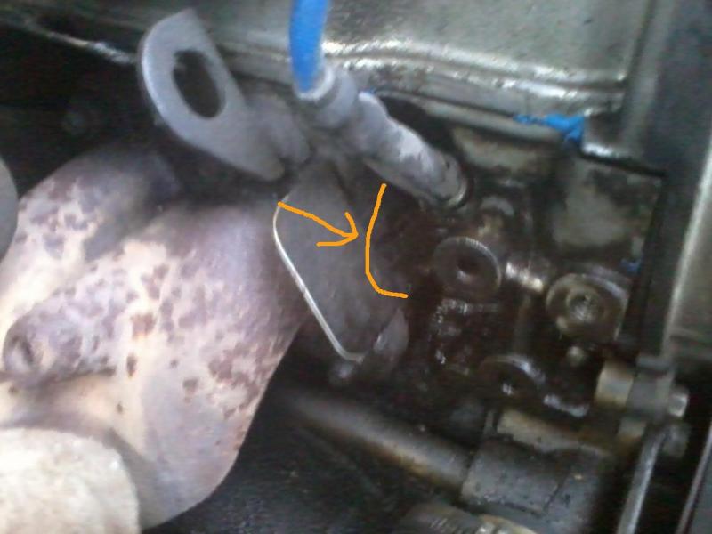

also looks like i may need to do a helicoil. the surrounding of the #1 plug is soaked in fuel i think. would that mean id have to do a helicoil? could that be the cause bad compression?

1 Attachment(s)
heres a pic of num1
Attachment 3735
not very good but i will get a better one tomorrow during the day.
1 Attachment(s)
Here is a CLT tester.
Attachment 3736

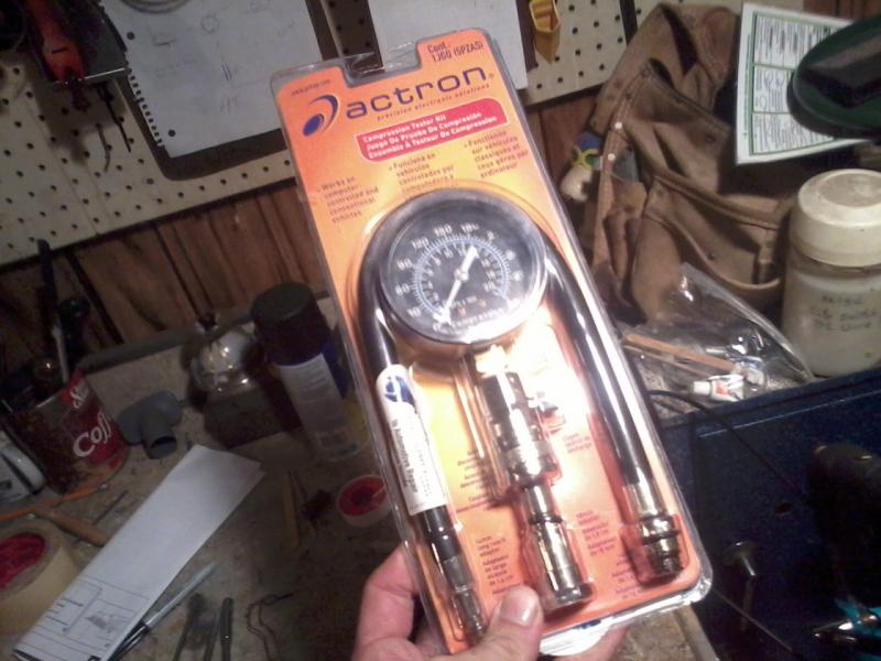

1 Attachment(s)
this is the one i have
Attachment 3737
1 Attachment(s)
heres a slight better pic of num 1
Attachment 3738
im going to hook the hose of the tester to a compressor later today and listen for leaks.
