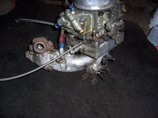

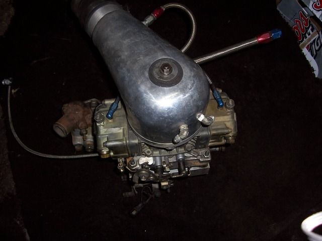

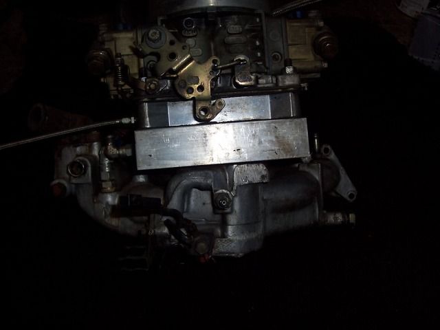

Postby conquest232 » Sat Jan 16, 2010 5:44 pm
here is a holley 4 barrel,,blow thru ,for the 2.6 starion,it was a special carb,,to my understanding
to be able to take the boost
i personally didnt use it,,,,the guy who made it,,said he liked it better than the stock injection
i dont know wats goin on with the img i cant resize my photos to make them work,,but if you click on the pic i think they work???
