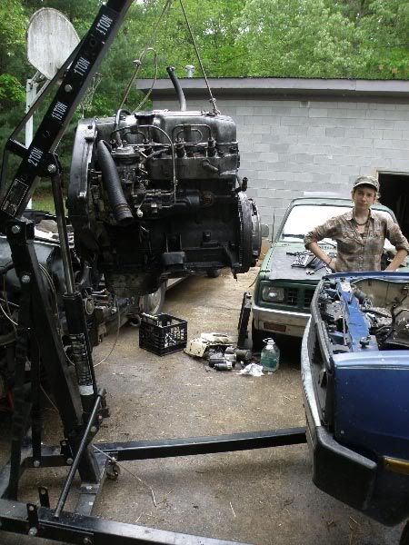

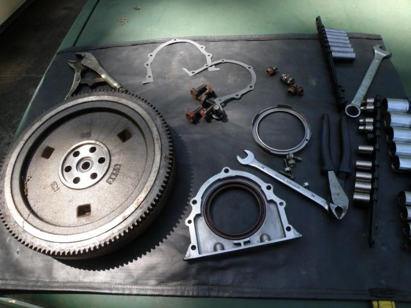

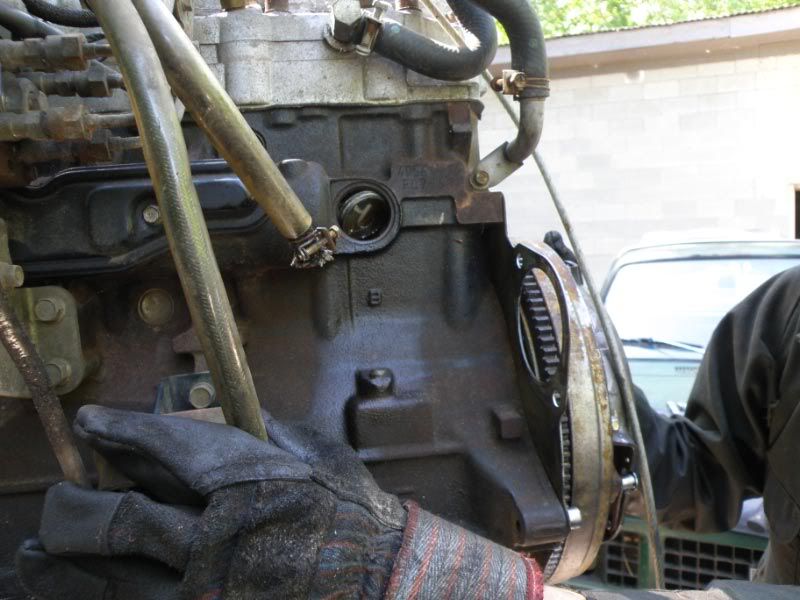

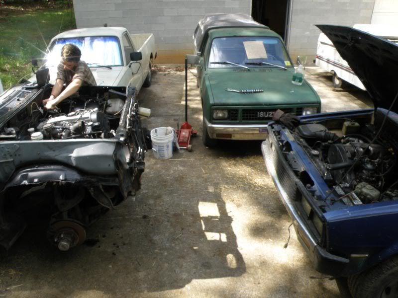

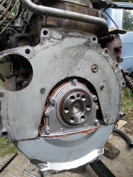

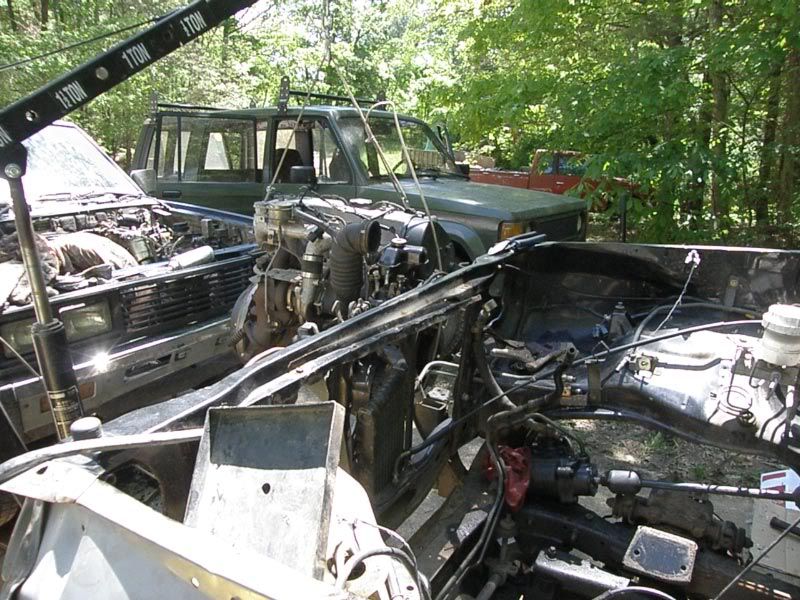

Postby bellavesus » Sat May 16, 2009 12:04 pm
ok so i have plenty of photos to show, but i am looking for a wiring diagram for the vehicle i am swapping the 4d56 from. it was a 95 mitsu pickup, from england. i am trying to swap the engine wiring harness over to the d50 to use the stock mitsu glow system since the d50s was way shot and cannibalized from previous owner*(s). anyone have one, or can get me a scan of the wiring for this system? i would be so grateful.
donor truck on left, recipient on right.
4d56 ready to be pulled. still have front axle, 4wd tranny and drivetrain parts too if interested lemme know.
4d56 out!
4d55 out, engine has 450 450 150 450 compression, any takers?
block heater to go in...
new timing belts, water pump, n front main seal- done!
rear main bits...
new rear main in!
sooo, i need the wiring diagram for the engine, mainly because i am trying to wire in the stock glow system from the donor
because the d50s was way shot to hell and cannibalized. where does the green and white relay wire go? etc...
