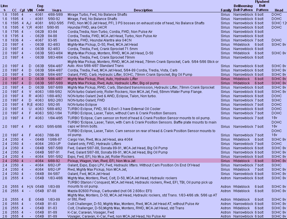

Whoa, y'all confusion sinks in. 2.0 is a narrow block, 2.6 is wide block. So how could a starion (wide block) trans work w/ 4g63? Or are you just saying tail section on 2.0 trans. Also, the whole starion motor mount on a 2.0 is odd. I'd figure you'd just use a 2.0 truck engine mounts. I dunno
not all 2.0's were narrowblocks there was a 4g63 wideblock

Fomes9282 wrote:not all 2.0's were narrowblocks there was a 4g63 wideblock

Ok yeah think I remember someone stating on the old site that a 2.0 w/ 5spd was narrow and w/ auto was a wideblock. Thankfully my buddy will be selling motor with a 5spd trans. Sad part is the Starion hit the junkyard and didn't see it in the upull it section. I'm taking my neighbor over tomorrow so we can hash out ideas and will try to get more info and pics! But regardless, its time to start working on getting a motor in the damn truck!

The trucks that were wide g63b's were autos only IIRC
