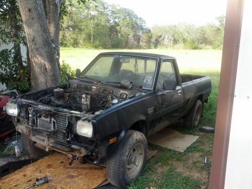

How's it going. I recently blew the 4g63 turbo engine I have in my truck. Ran out of oil and pulled to the side of the road added a quart of oil I had in the cab as a just in case to make it home. On the freeway it mad a weird sound and pulled over. Checked for anything leaking and the fluids. Cranked the engine till it made a few thuds and it locked up. Oh well, rebuild soon. Right now I got a spare 2g eclipse head and my complete g63b to work with along side what I can still use off motor in the truck right now. Still will make use of my web cams 546/547 and gears and such. Hopefully the head itself is still good. Ima tear open the engine as soon as I got the time. I know Ima order the jay racing alternator relocator kit and the balance shaft eliminator kit as well as new pistons and rods. Don't know who to go with, or if my arp headstuds are reuseable. :?
Hopefully I have the time to get it running by next month cause I know my funds are limited.
